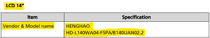

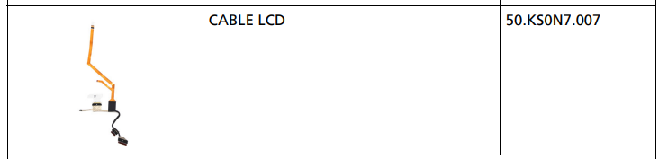

    The screen flashing on opening, or intermittently and the USB-C port that wasn't working, freezing, and failure to power up are not something that can't be fixed with a mainboard replacement, especially the USB-C port, with the screen, its either an eDP cable that is faulty or its the screen that is faulty. So get Acer Tech Support to replace the cable and screen with a new screen as then Acer have virtually replaced the whole laptop. Good luck and hope this helps you out.
    These are the eDP cable and screen that you need to get Acer Tech Support to replace.

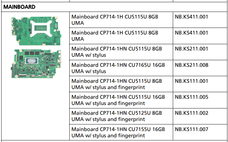

    These are all the mainboards fitted to the Chromebook Spin CP714-1H models for your reference
