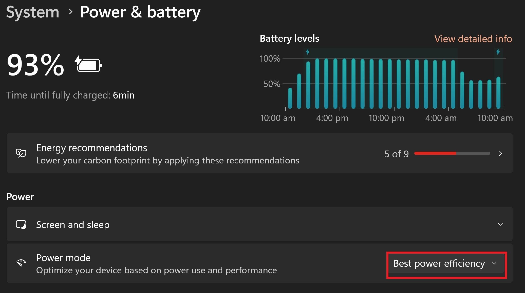

    Hi, The Acer Aspire 5 A515-56G is not a gaming laptop, It’s best described as an all-rounder with light gaming capabilities. use Balanced Power plan and Best Power Efficiency mode in Power & Battery settings and disable Turbo Boost.

    Hello, yes I'm aware of those settings, the turbo boost is already disabled also I'm using the battery on power saving mode.
