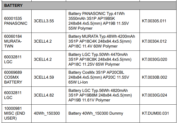

    Batteries for the Swift SF314-43 model laptop
