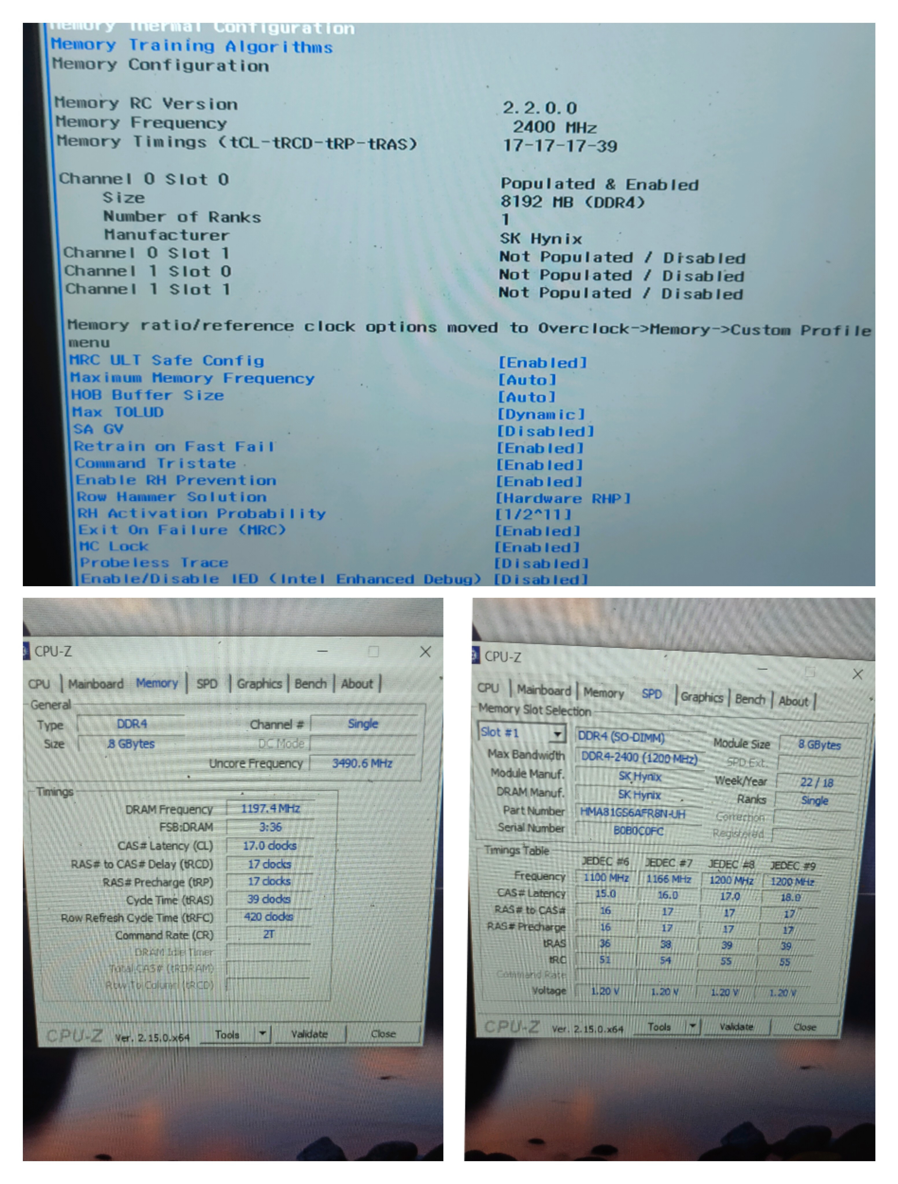

Initially, there was a single DDR4 2400 MHz 8 GB RAM module. Now it has been upgraded to dual-channel DDR4 3200 MHz, 2x16 GB = 32 GB.
(At first, the system did not boot due to the 3200 MHz speed not being supported by the motherboard and processor. Later, the frequency was manually adjusted to 2400 MHz via the BIOS.)

Old vs new RAM comparison (BIOS and CPU-Z images)
Old Ram:
New Ram:
