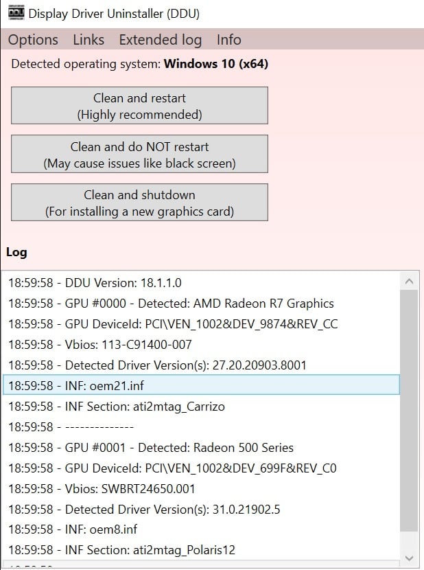

    @Nitro5user83
    Please open your device manager and post a screenshot, I should see the ones that are not installed listed.
    The biggest reason why the problems are not solvedis if someone who says there is a problem with the GPU says; If I change the case, will the problem be solved? That's the whole point! The concepts are different! We should not go off topic.
  • Nitro5user83
    Nitro5user83 Member Posts: 46 Enthusiast WiFi Icon
    I currently have installed the OEM chipset drivers so there are no missing devices in device manager. I installed only the chipset drivers from the OEM install package, no display driver no catalyst control center. I then installed the 23.9.2 RX550 driver that you recommended, again driver only install. The R7 driver that is running is the one that windows update installed automatically. Whenever I try installing a newer R7 driver I get a black screen and windows fails to start on rebooting so I have to do a system restore to get back to running again
