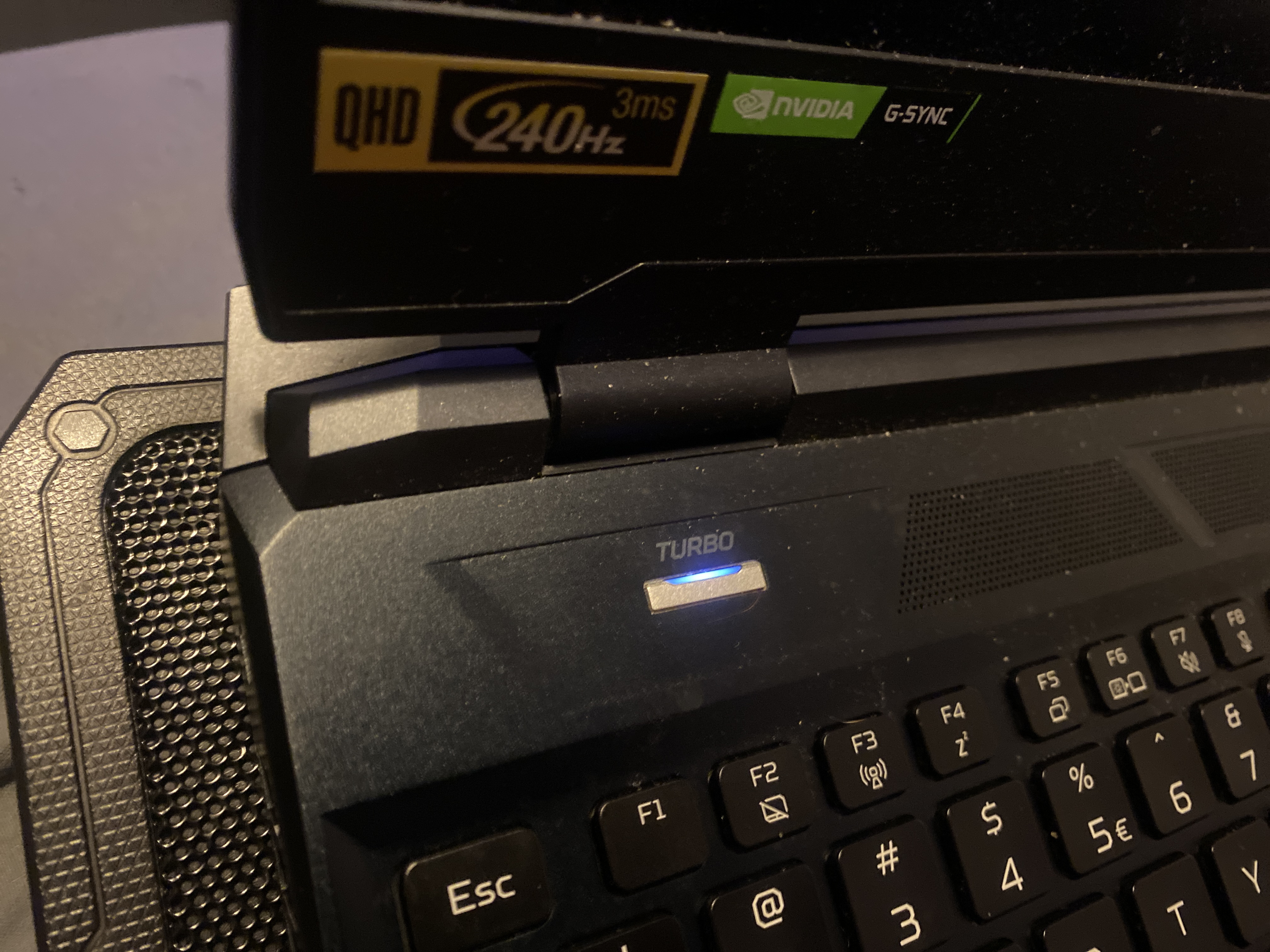

I have an acer predator Helios 300 that used to belong to my cousin for years. I replaced the thermal paste today, attempted to start it up, and sure, i hear it power up, but I don’t see my keyboard or screen turn on. I cleaned off any excessive thermal paste. No change. Did a battery reset where I disconnect both battery and coin battery, no change. I connected it to my tv to see if the screen would pop up there, nothing. Please help.

    Hi, I noticed that you are using the laptop on a soft pillow completely blocking the air inlet fans at the bottom, also fluid containers are precariously close to the laptop ready to topple and spill on the keyboard. Besides this, check the RAM modules and if nothing helps bring the laptop to a qualified and preferably Acer accredited PC repair shop in your area to check the motherboard and EDP/KB cables.
