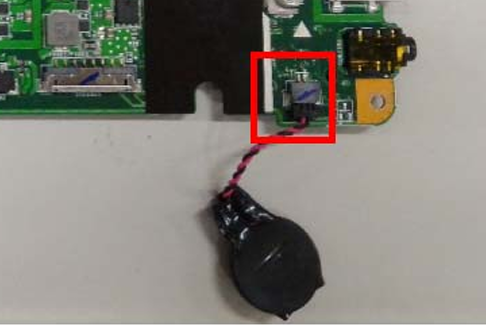

    Do a Hard Reset by taking the main battery out first and then press the power ley for 10 seconds to get rid of all power that is in the laptop, then disconnect the RTC/BIOS battery and short this batteries +&- pins at the mainboard plug to reset CMOS, then leave the laptop like that for 30 min and then reconnect everything and see if that fixes the issues, as doing this resets the laptop completely. Good luck
    RTC/BIOS battery and it board plug
