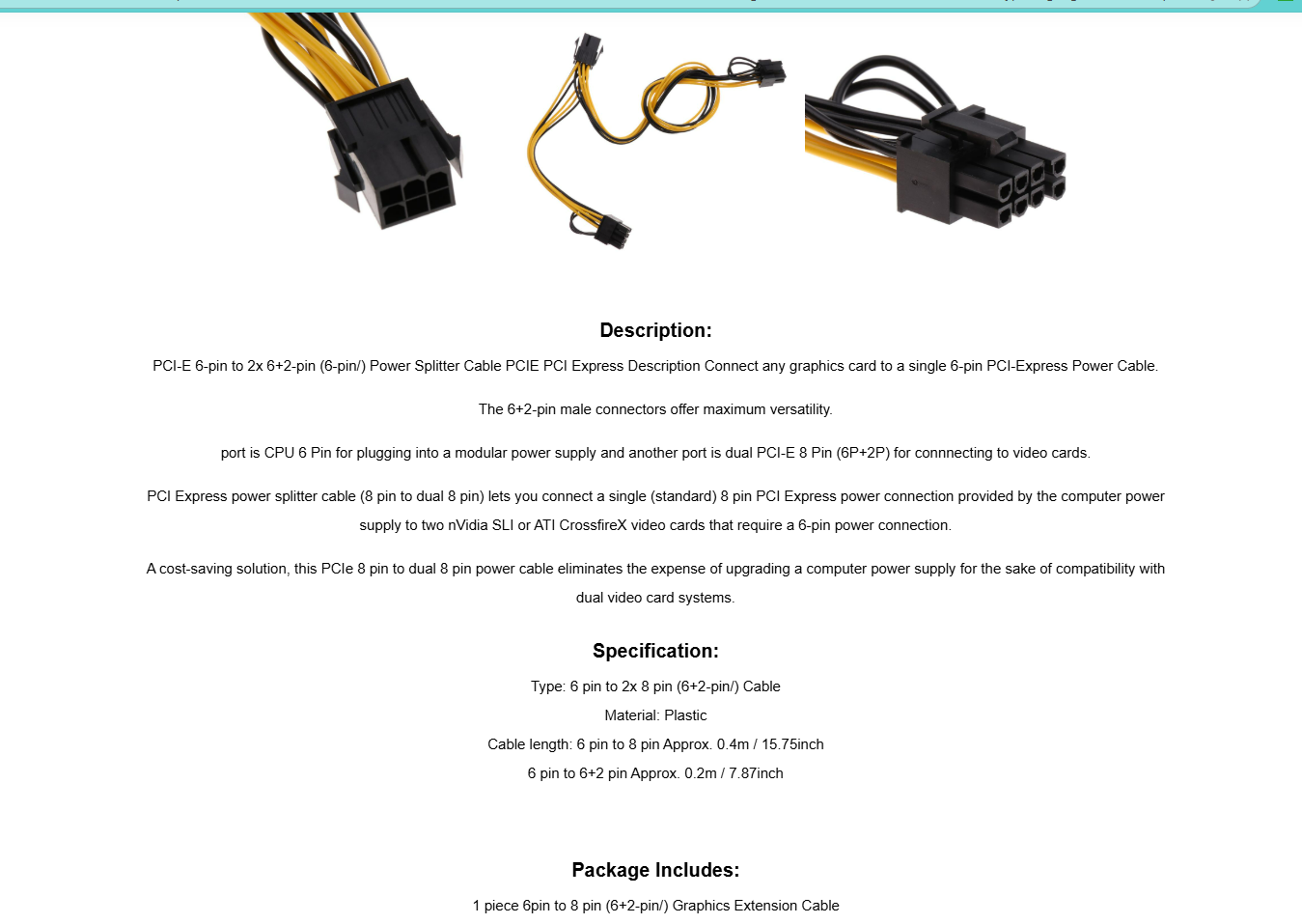

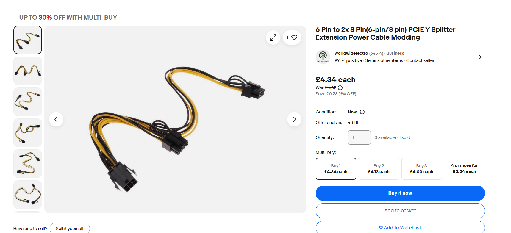

  • Mintibritches
    Mintibritches Member Posts: 9
    Tinkerer
    Thanks @billsey and apologies for late response/acknowledgement.
    Is it this splitter i need ?
    So i would unplug the power from the MB, plug that end into the 6pin splitter, and then use the 1st 6+2 to connect back to MB, and the 2nd 6+2 into the GTX ?
