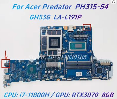

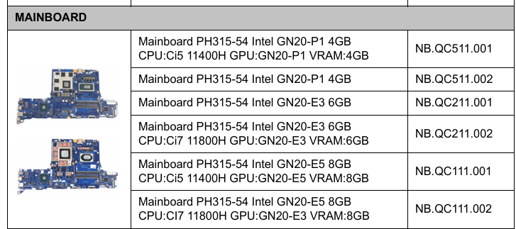

    Sorry to hear that joealex, as that is NOT good news or a good sign, as you might have blown either the BQ, EC or chipset chips in your laptop or if you are lucky its only the main power rail that has a shorted mosfet or a capacitor or a resistor or even an EC chip that needs programming or BQ chip that all relate to the laptop powering on and can be changed with new chips.
    But if you shorted the gpu, cpu then you need a new mainboard or even a chipset chip, as a suitable and a good chipset chip is very hard to buy on the web for a Predator PH315-54 like yours, as allot that are sold, are faulty and they are not guaranteed, as they can be changed and a laptop can be fixed if it has a burnt out chipset or even a cpu or gpu, but you need to find good working and the appropriate parts, as Intel, Nvidia and the chipset manufacturers do not sell new.
    I suggest that you take your PH315-54 to an experienced technician that has expertise in fixing mainboards with these sorts of chip problems and power issues and can detect a blown chip with a heat gun and can determine if a BQ chips or an EC chip is blown and program an EC chip, as all these factors could be at play with your laptop to be fixed.
    Otherwise and an easier solution, is to buy a new mainboard like and from AliExpress that for an i7-11800H RTX3060 6G board is USD $600.00, and you can change this over yourself if you are computer savvy and organized, as its a pretty easy job to do.
    These are the PH315-54 boards that Acer fitted to your laptop. If you change the board, I suggest that you sell your old damaged board, as allot of techs buy these gaming boards for spare part boards, for their cpu's, gpu's as some techs do change laptop gpu's and cpu's if they get good working parts. Good luck and hope this helps you pout.
