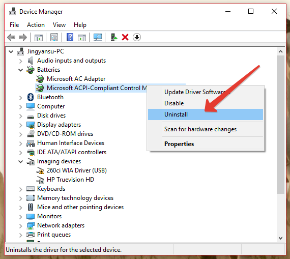

    You can try to reinstall the battery drivers to check if that makes any difference.
    Windows 11 Battery
    NOTE: Make sure to reboot the laptop after uninstalling the driver.
