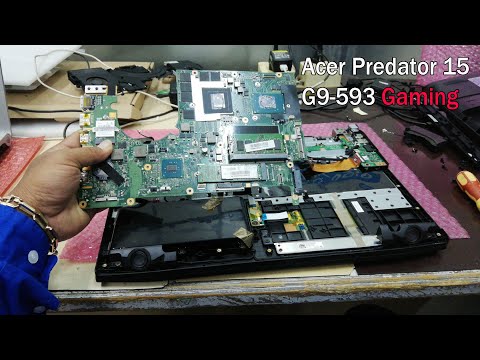

  • You will need to remove the motherboard, see:
    https://youtu.be/qRD9E_yV7-U
    Then you will need to remove the black anti-static sticker. It is likely that the keyboard is soldered to the upper case. You will need a soldering iron!
