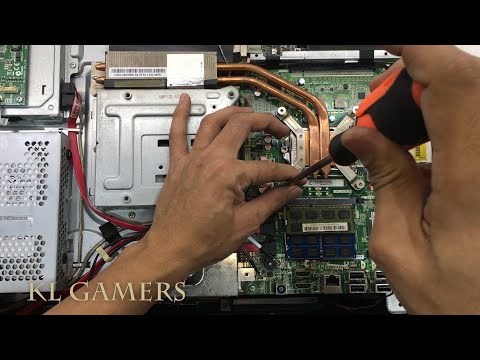

    video where they remove and reinstall a working GPU while working on the processor... https://www.youtube.com/watch?v=CtdCmUsneEY
    My new GPU is a different model but similar.
