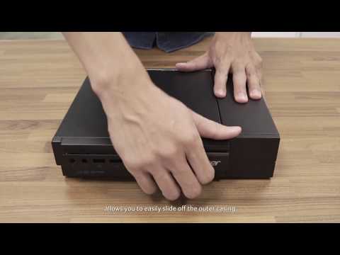

  • Larryodie
    Larryodie Member Posts: 1,999 Community Aficionado WiFi Icon
    This video may give your some more information on how to install but I don't know of where to buy the expansion module ?  Good Luck.
    https://www.youtube.com/watch?v=-93GFWFe2ao
