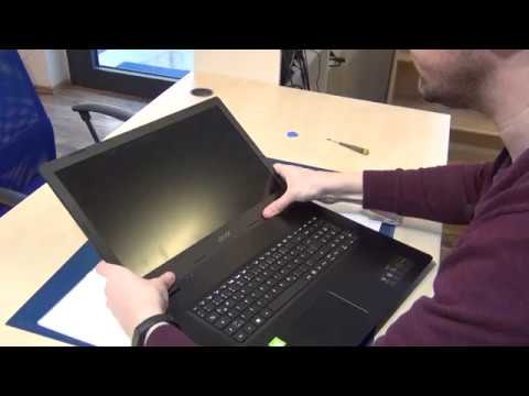

     like this.
    https://youtu.be/4FbD1PWm5C4

    The video shows a model that has its LCD held in place with screws. The C871 has its LCD held in place by double-sided tape as shown in the previous answer. We ordered replacement LCDs but tape was not included.
