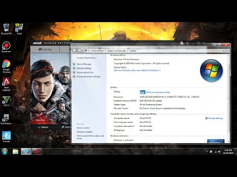

    What about this guy who installed it on the same processor as mine https://www.youtube.com/watch?v=yGQ1rnhNBBE

    No, but he was able to install the driver on windows 7 instead of win 10, in my case I can't install the driver he installed on his even if we have the same processor.
