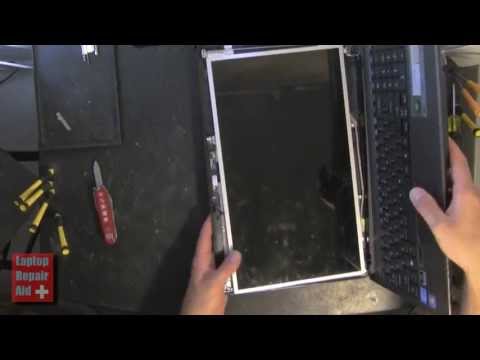

    I managed to remove the magnet and everything seems to work fine. i.e. The machine will resume from suspend while closed. Kudos to Acer for at least making the disassembly straight forward. For anyone else wanting to try the same, there is a useful (but not particularly necessary) video here that shows bezel removal.
    The magnet is taped to the bottom left of the bezel frame (just above the power button) and is easily removed.
