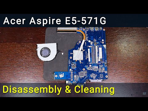

    OK! I understood! See the thermal paste that the author of this video used:
    I don't have much experience with the GD900 thermal compound. In addition, just apply a small amount of thermal paste, the size of a pea, as the heat sink itself will spread the thermal paste
