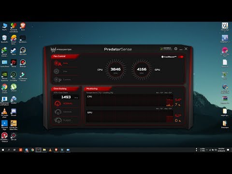

  • andylb
    andylb ACE Posts: 3,827 Pathfinder
    Turn off Turbo Boost, watch this video
    https://youtu.be/g8nDOzljulk

  • brobrobro
    brobrobro Member Posts: 4 New User
    I think what you sent me is an old Helios 300, what i mean is the 2019 Helios 300 and i dont turn on my turbo. It's the cpu that's having a high frequency
