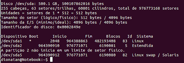

    To recover grub, perform the following procedures:
    The first step is to have at your disposal a live DVD or Ubuntu live pen drive.
    Boot normally, as if you were to format the computer with Ubuntu, however, start the system in live mode, the same way you do when you want to test the system before installing.
    Once on the desktop in live mode look in the system menu terminal, in it we will give 3 commands to recover grub.
    The first command is for you to identify on which partition you have Ubuntu installed.
    sudo fdisk -l
    The answer will look something like the image below, however, NTFS partitions should appear too:
    https2bpblogspotcom-sbAUuB_6ipEVcEYPtiNxuIAAAAAAAAQ60ZV2Jrhle1gcs640Captura2Bde2Btela2Bde2B2015-08-042B16253A53253A01png
    Notice the partition table that is shown in the bottom half of the image (above), on the right side it informs that the partition / dev / sda1 contains Linux, that is, in that partition the system is installed, this step is important because it can vary (probably goes) from computer to computer.
    The second step is to mount the partition that you identified in the previous step, so run this command by modifying the partition that matches your computer's partition.
    sudo mount -t ext4 / dev / sda1 / mnt
    Where the text in red is part you should put according to the partition where Ubuntu is installed on your computer, in my case it was / dev / sda1 but could be / dev / sda2 (sda3, sda4 ..., etc.). )
    In blue we have the file system, which is usually Ext4, in case you have installed Ubuntu with another file system modify this session, otherwise it will not work. If you "just" installed Ubuntu, the system will be Ext4.
    Now comes the comado that will reinstall GRUB itself:
    sudo grub-install --root-directory = / mnt / dev / sda
    With this your GRUB will be back, restart your computer and run the tests.
    sudo fdisk -l
