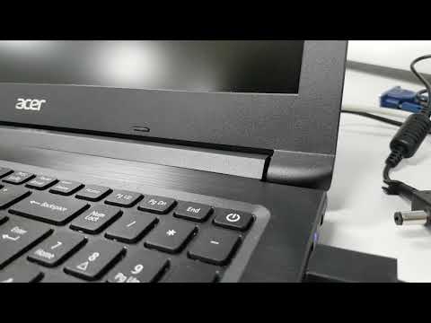

Strange one this.  I can't tell if this is a Windows 10 or an Acer issue.
When on battery and the screen turns off, I can hear the hard drive constantly powering down and up.  It sounds like it's going through hell.  This doesn't happen when connected to the mains.
Check out video in the link.  You might have to turn the volume up.  You can hear the hard drive doing the thing I mention once the screen goes off.
I thought it might be the power settings.  So I went to advanced power settings and set "Turn off hard disk after 0 minutes (i.e. never)" on both battery and power but it didn't make a difference.
https://www.youtube.com/watch?v=qVO7Bkz1t64
Thanks in advance.

    By the way, just as a follow-up, I never did get rid of this problem and basically just used the workaround mentioned above.
    Eventually, I upgraded my primary hard drive to an M.2 SSD for separate reasons whilst keeping the mechanical drive in for storage.  This wouldn't have solved whatever the underlying issue was but it meant the mechanical drive stopped doing the clicking when screen went black.
    By the way, I can highly recommend upgrading to an SSD if you can.  Made a world of difference to the laptop's performance.  Especially on boot/login and but especially when the OS was reading/writing the pagefile so switching applications was so much faster!
