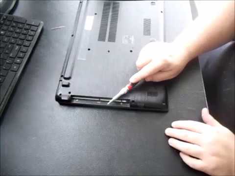

If it does not power up, then it gets more complex.Check your warranty status. If out of warranty, you can try to re-seat the RAM stick(s). It's moderately difficult. Note at 3:12 the warning about wires & connect to the front that must be disengaged. Not shown in the video. If it's not the RAM, then it may be the motherboard.0
