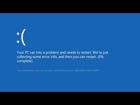

    I changed the Boot Mode to [Legacy], and I rebooted then the following Windows blue screen appears
    Your PC ran into a problem : (
    Stop code: INACCESSIBLE_BOOT_DEVICE
    Boot Mode [UEFI] is recommended by Microsoft on Windows 8 or above in order to enjoy the performances.
    I'm sorry for the smileys, I cannot edit it anymore.

    The stop code: INACCESSIBLE_BOOT_DEVICE, is only on [Legacy] boot mode. But I want [UEFI] recommended by Microsoft.
    When I switch the Boot Mode from [UEFI] to [Legacy] then the following message appears in the BIOS settings:
    "Microsoft recommends executing Windows 8 and the version above under UEFI boot mode to enjoy the full features."
    But my Laptop doesn't support Windows 7, because the double click on Windows 7 never work in my Laptop. I must use Windows 10.
    So the conclusion is the message below appears (under UEFI boot mode) after reboot and after Acer logo:

    That's an advertisement, ignore it, you can do a clean install by downloading Windows 10 and install it in UEFI mode. Follow the instructions here:
    https://www.tenforums.com/tutorials/1950-clean-install-windows-10-a.html
    This will delete all your data from the hard drive, so you better try the Repair install method from here:https://www.tenforums.com/tutorials/16397-repair-install-windows-10-place-upgrade.html
