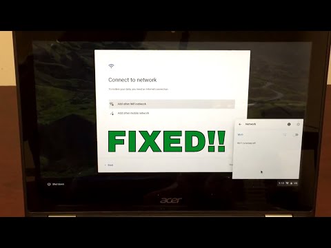

    We have the same problem - happened about a year after purchase in NZ from PB Tech.   Powerwash does nothing.  It will randomly start working again - so difficult to send for repair as its intermittent and we didnt want to be without it for months (needed it for school).       Luckily its an easy temporary fix by anyone with a small philips screwdriver.   Power it off.  Undo all the screws on the back and carefully lift the back off - Remove the wifi card (has 2 wires attached to it), and reinsert it. I didnt bother removing the wires as they are fiddly.     Put the back back on, and reboot.  It should work - for a couple of months before you need to repeat.   This seems to be a known issue,  and Im pretty disgusted with the hardware quality from Acer on this as I paid extra to get touchscreen etc and assummed this was a quality unit.   The Wifi fault makes it totally unusable.   video on process here https://www.youtube.com/watch?v=ejC_h-l7c1U&ab_channel=TechGuru    Acer should be doing a recall on this as its shoddy hardware
