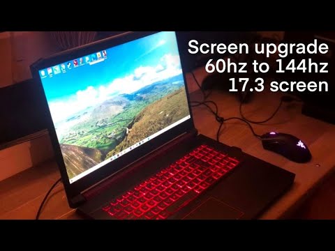

  • Ashbuilt
    Ashbuilt Member Posts: 1 New User
    Hi guys/Girls
    I have upgraded my acer nitro 5 17.3 screen from a 60hz to 144hz
    check out my youtube video showing and telling you how I did it. Also if you don't mind as a thanks give me a subscribe ;)
    https://www.youtube.com/watch?v=c4rw8yNbfSo&ab_channel=AshBuilt
