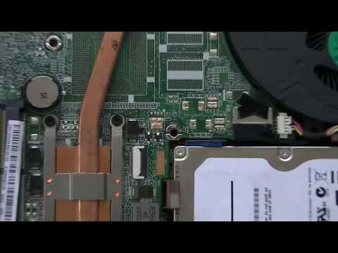

    Pardon my French, but what the actual *beeeeeep*?! There's one of the screws in an M5 that acts as a jumper (think of it a short wire), what kind of design is this?!
    Anyway, if yours is such an unit, check that the screw in that place is present (obviously) but that it's properly tighten too, it has to make contact with some metal parts for the battery to charge in those models apparently:
    https://www.youtube.com/watch?v=JaNHJzpp93g

    Summing up the video I linked to a little bit, he had a customer (I presume) that wanted to replace the battery because it wasn't charging. He explained that one of the screws actually acts as a jumper bridging 2 points in the motherboard and is responsible for the charge to being. He went on saying that if you wanted to check if that was the cause you could kick-start the charge by using a pair of tweezers and connecting those 2 sides manually with the laptop disassembled.
    He also stated that it could have been meant as a security measure so the battery was disconnected when the case was removed, but that you could solder those points and leave them permanently shorted... (but now we're digging in deep haha).
    If you feel like disassembling the laptop, give that a try (the using of tweezers, not soldering haha) and see if there's corrosion in that point or the screw that could prevent them from making good contact, and disconnect-reconnect the battery connector to the motherboard for good measure.

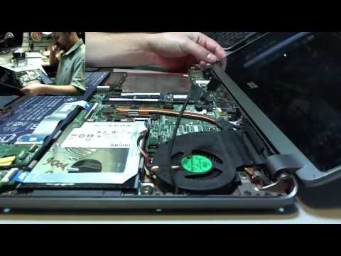

    In any case, in this video a guy is disassembling an M5-481PT, he's purpose is to replace the fan of the CPU; but the battery is disconnected around the 5:12 minute mark, that white connector with several cables is the one that comes from the battery:
    https://www.youtube.com/watch?v=EtB_boan-mA

    I think yours ought to be similar, to the first one but you'll see if there's anything in the way of taking the battery out like screws, flex cables etc. once you are removing it. As long as you're methodical and note or remember where everything goes it should be easy ;).
