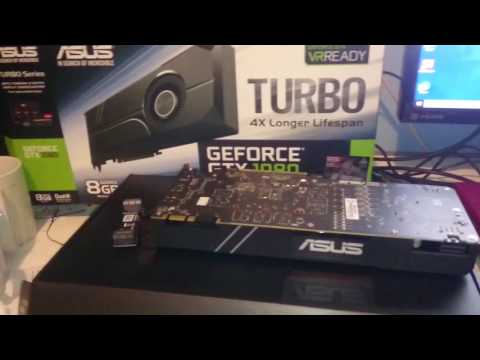

    The guy in video below had to go to device manager and disable Intel graphics too. Very strange.  You can try DVI cable too....I guess.
    https://www.youtube.com/watch?v=3rfe0jYSpUg
