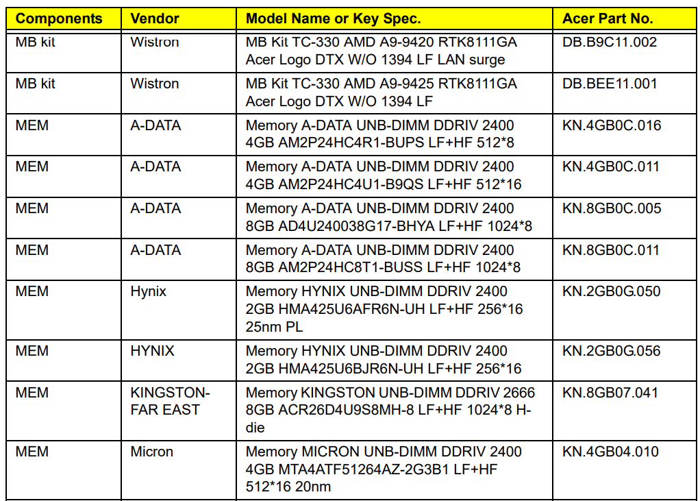

There are 2 RAM slots. But one of them has never been used. Now I bought a new RAM module to upgrade the machine to find that the slot is not work.
What I have done is cleaning the slot with contact cleaner. But it is still not work.
What else can I do to make it usable?

    I have given the RAM upgrade specs below, so please check the RAM you bought has all these mentioned below.

    Thank you for your guidance. But I verified the newly bought RAM module that it’s compatible with the unproblematic RAM slot. I also checked the problematic slot alone using the old RAM module and found that the computer would not boost, I mean nothing was shown on the screen.
    My question is what can I do to fix the RAM slot in problem?
    Thanks again anyway.

    Check the RAM UDIMM 288pin slot if its pins are not damaged and if all the 288 pins are properly soldered to the mainboard, as that could happen and they come lose for an 8 year old desktop. Also make sure that you have fitted the Acer recommended ram below and its not XMP type ram as only normal ram works with this desktop.
    This is the memory that Acer tested this desktop with and recommends.
