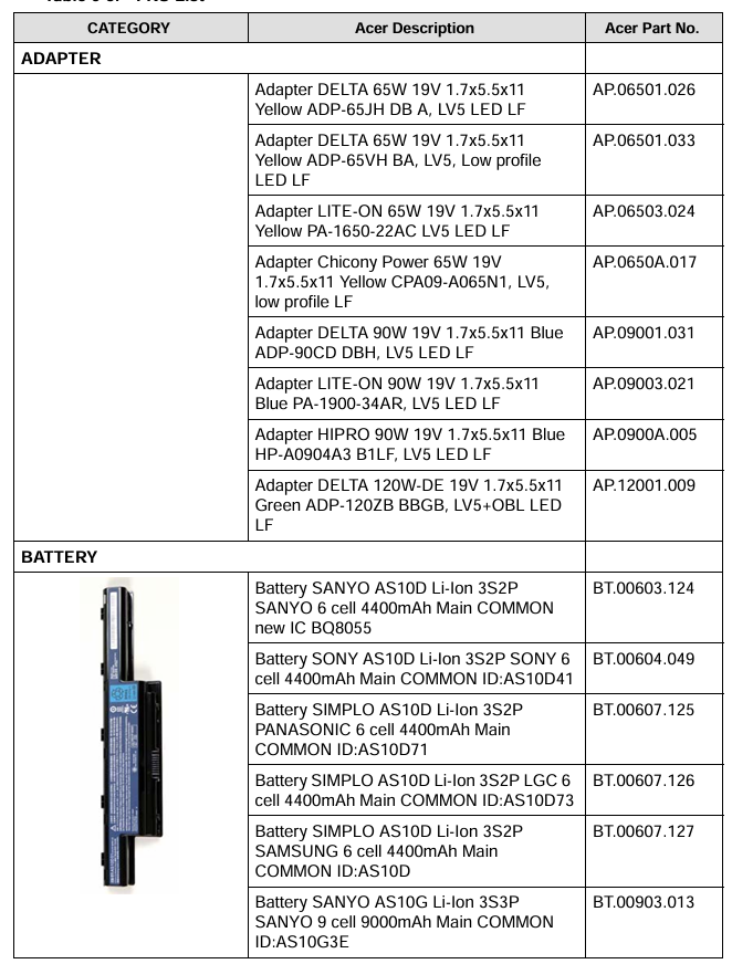

    I suggest that you only use genuine Acer oem battery and adapters that Acer lists for the Aspire 7750G below, do not buy and fit copy replacement parts for this old laptop, as that is what will give you problems with these old batteries if they are not a genuine listed and recommended Acer product. Buy and use ONLY the below listed parts for the Aspire 7750G laptop, as its from its service guide.
    The HelpDrivers site is the most comprehensive source for drivers for these old laptops to what I've experienced, if they don't have the driver that you want, then it will be very hard for you to get it, as Acer has stopped all support for the Aspire 7750G laptops a long time ago. Good luck and hope this helps you out further.
