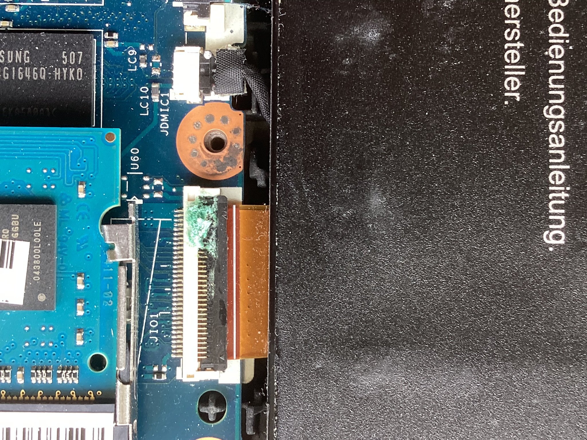

    Ah… looking at the inside reveals a problem. This is near the battery, but is actually the ribbon connector that comes from the USB sockets (right hand side when using the laptop). The green looks like copper corrosion - how can this have happened? I had left a wireless mouse dongle plugged in to one of the two USB ports but surely this shouldn't be a problem?
  • Flopsy
    Flopsy Member Posts: 4 New User
    BTW I cleaned it up as best I could but there is still some corrosion damage there (even on the black push-down connector).
    I tried booting it, with and without the ribbon cable in but it's still the same. Presumably it's failing some low level boot test. Looks like the laptop is toast unfortunately.

    For some reason the equipment has moisture, hence the green sulfate. The bad thing about moisture is that when the equipment is turned on, it can cause electronic damage, which is possibly the reason, although I cannot be sure.
