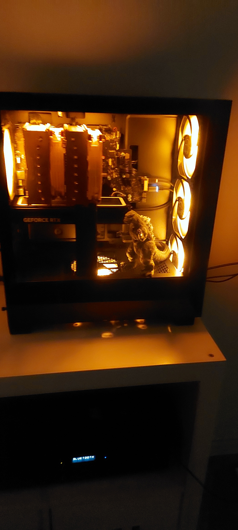

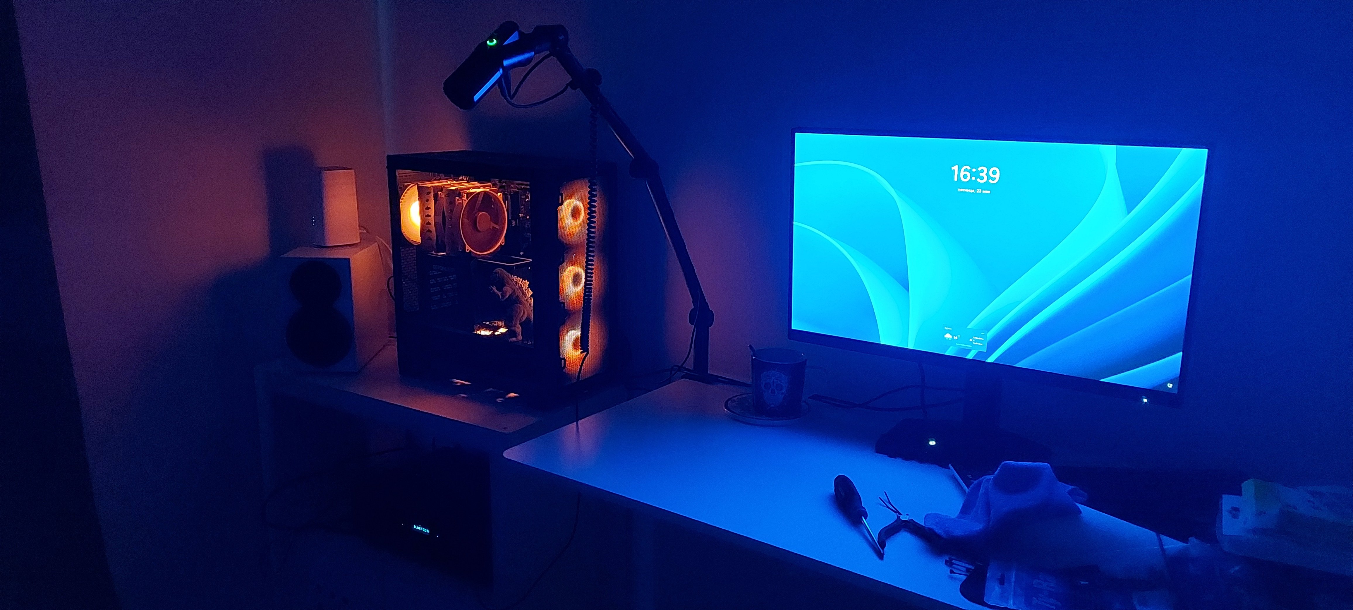

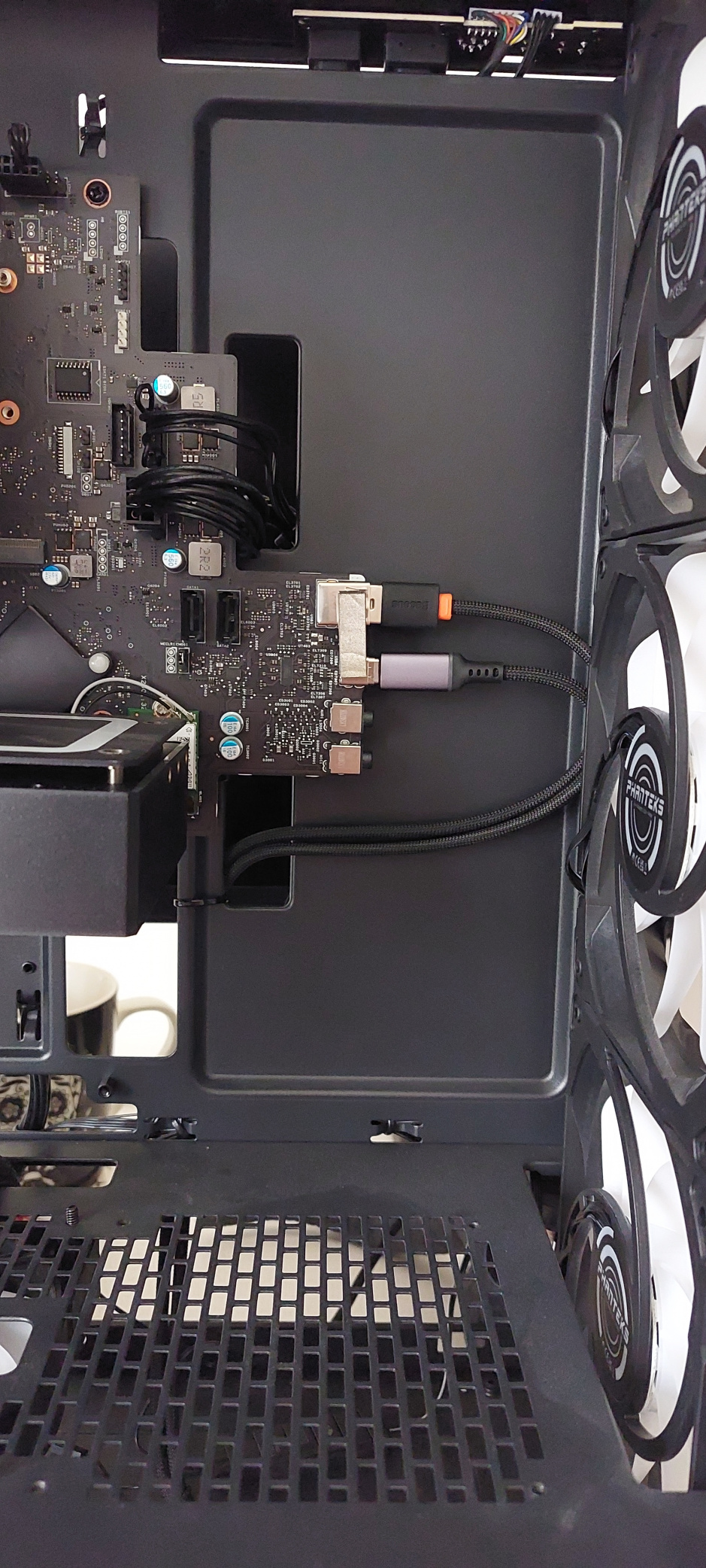

    For the lighting, I ended up using the Fractal Design Adjust R1 RGB. It works independently without needing a motherboard connection and remembers the lighting mode when the PC powers on. There aren’t many modes, but the static amber is enough for me.
    I also used the front motherboard ports: a 50 cm USB Type-C extension cable, which makes it accessible without opening the case. For regular USB, I used a 2-meter hub placed under the monitor, where I plugged in the mouse and keyboard.
