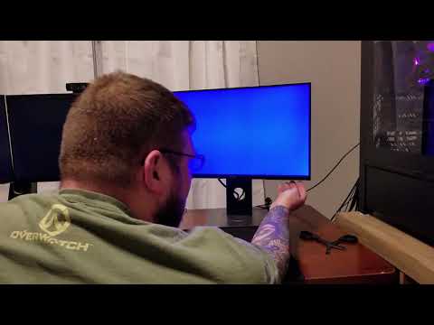

  • This user has a similar problem with a dell monitor:
    He accessed the factory mode of the monitor and it seems that he changed the burn in pattern setting!
