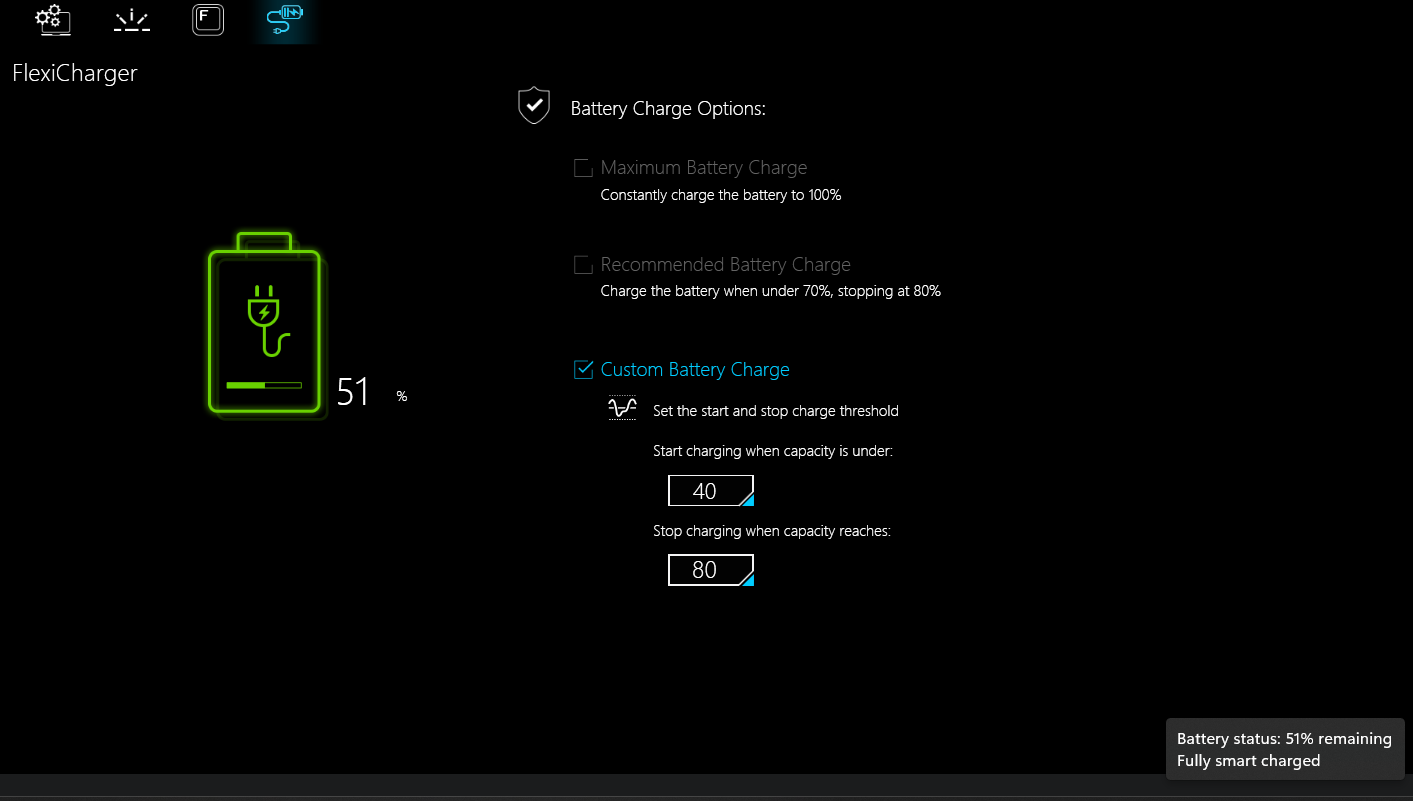

I have a specific bug with the Control Center software on my ALG (AL15G-52).
When I go to the "FlexiCharger" tab, the "Maximum Battery Charge" (100%) and "Recommended Battery Charge" (Stop at 80%) options work perfectly.
However, the "Custom Battery Charge" option is bugged. When I select it (for example, to stop at 80% and start at 70%), the software breaks. It takes whatever my battery's current percentage is (e.g., 54%) and reports it as "fully smart charged," and the battery stops charging or discharging. The battery level is just frozen.
This shows the hardware is fine, but the "Custom" setting in the app is broken.
