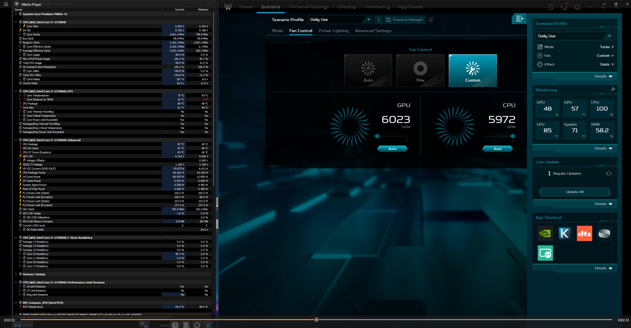

🟢 1️⃣ Idle / Before Cinebench
CPU: ~57 °C | GPU: ~47 °C | Fans: ~3100 RPM
(Normal idle behavior)

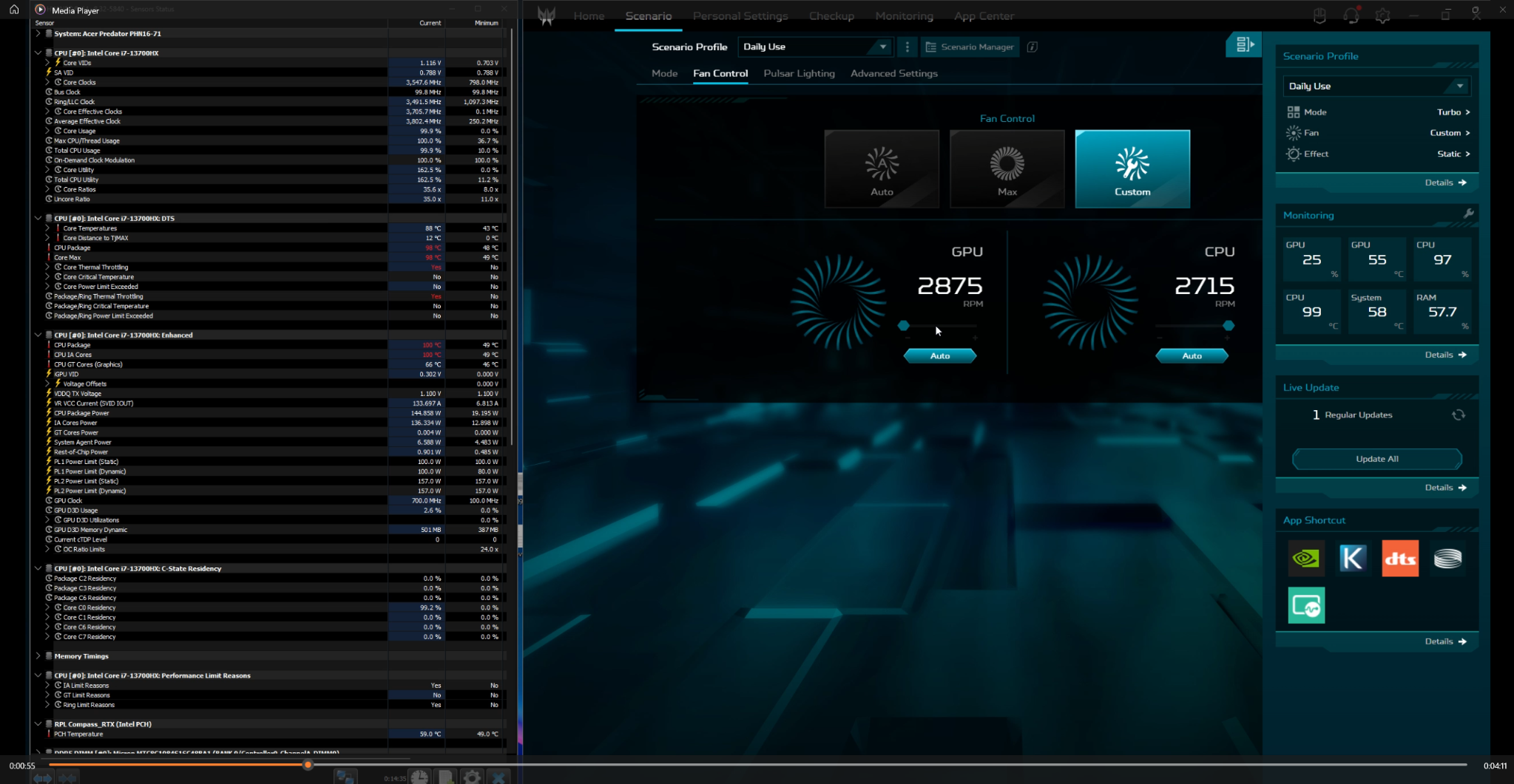

🟠 2️⃣ Early Load (Cinebench started)
CPU: 99–100 °C instantly | GPU: ~55 °C | Fans still at 2700 RPM
(Rapid thermal spike before fans fully ramped up)
🔴 3️⃣ Full Load
CPU: 99–100 °C | GPU: 60 °C | Fans: ~6020 RPM
(Fans at full speed, but CPU remains at TJmax)

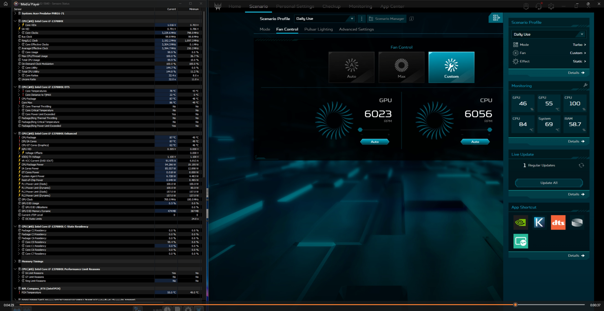

🟡 4️⃣ Mid-Test (Stabilized)
CPU: 85 °C | GPU: 57 °C | Fans: ~6000 RPM
(Temperature stabilizes slightly after full fan ramp-up)

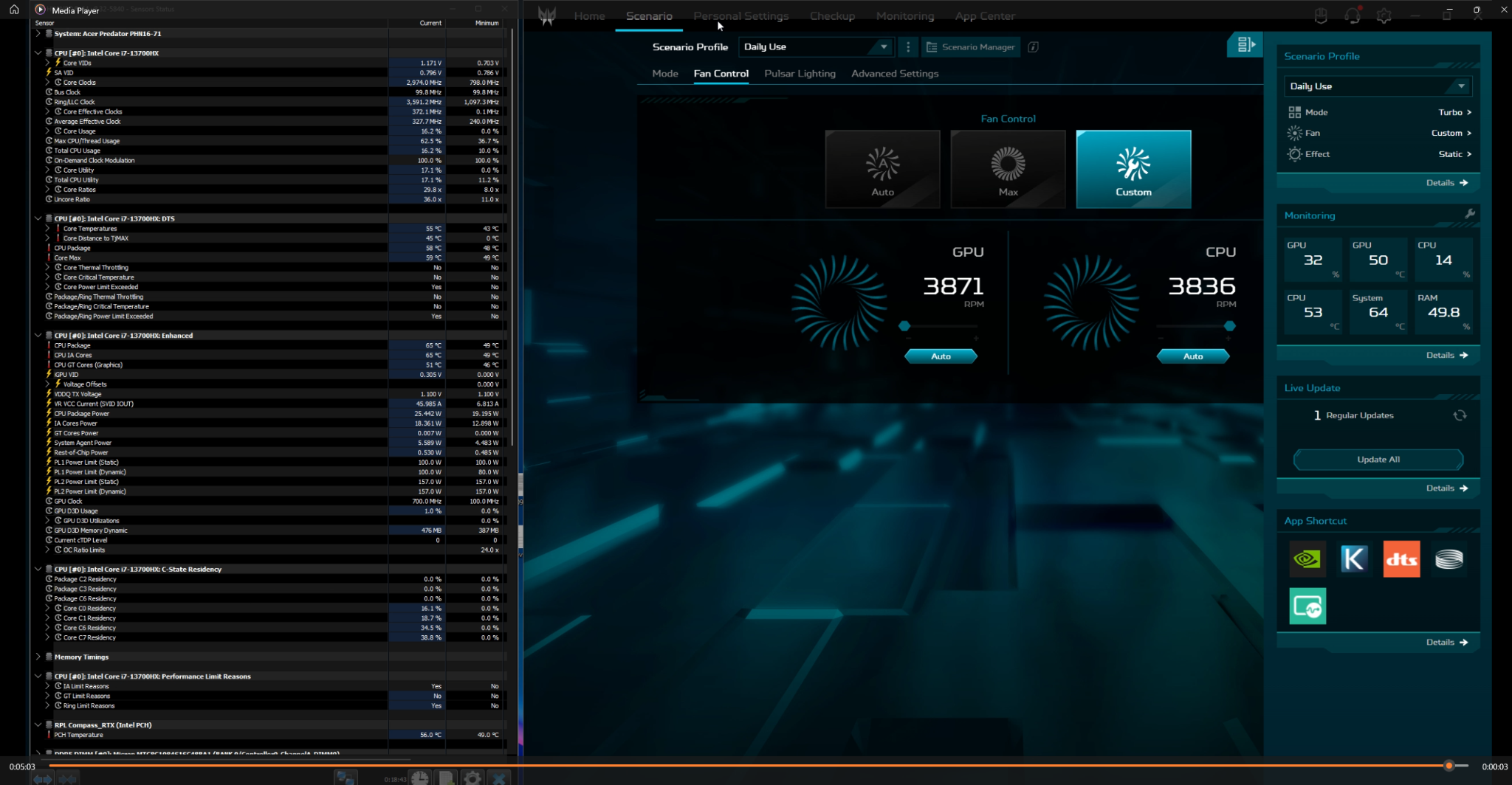

🔵 5️⃣ Post-Test (Cooldown phase)
CPU: ~53 °C | GPU: ~50 °C | Fans: ~3800 RPM
(System cools down normally afterward)

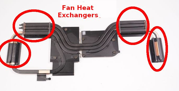

- Missing foam air seal, reducing pressure through CPU heatsink fins.

- Does the Predator Helios Neo 16 (PHN16-71) with i7-13700HX ship with liquid metal on the CPU (as some teardown videos suggest)?
- Can the missing foam seal on the new FCN fan significantly affect CPU heat dissipation or airflow direction?

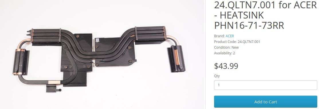

- What are the official part numbers for the CPU and GPU fans for PHN16-71, so I can confirm full compatibility with my FCN replacements?
