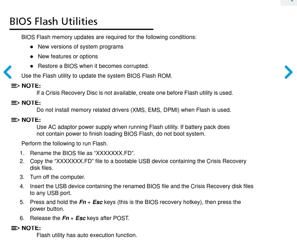

I thought this was a bios corruption so I downloaded a BIOS online because Acer has stopped support for this device. I tried to use some online guides but none of them are useful. My BIOS structure is different from the ones given online.
I have a .exe and extracting that gives some files and two folders named BIOS and KBC . In the BIOS folder there are two .ROM files. I tried to flash the one which I have determined as corresponding to my device and it does nothing. I remove the battery, insert pendrive, press Fn+Esc and then plug in the device after which I power it on. The display does not start(that's a change) but there is no flashing lights as descibed in the various guides. Only a single blue light is there without any flashing and nothing ever happens. I have tried many different names but I just cannot figure out anything for this. I am not even sure whether I am using the correct method of flashing.
