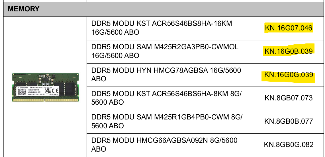

I bougth a couple GSkill Ripjaws for my laptop so i could upgrade from 16GB to 32GB, during the installation, i grounded myself and disconnected the BIOS battery and main battery pack from the motherboard to prevent any shorts or unexpected behaviour. After i plugged both batteries in, i lost my BIOS configuration (as expected, since i removed the battery for an extended period) and had to reconfigure my Dual-Boot setup (i've done this with rEFInd from my PopOS! installation).
When i had that done, i booted back into Windows and noticed it had some problems booting up the RTX4060, since it was showing a warning symbol on device manager, noticing this, i checked for driver updates on GeForce Experience for the graphics card and also checked for BIOS updates on Acer official page, expecting them to solve the issue.
