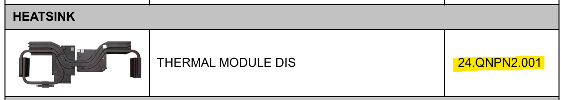

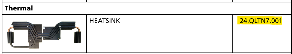

- Can someone confirm if the left fan is for the GPU in the Helios Neo 16 (PHN16-71)?
- What is the official part number for the left (GPU) fan, so I can purchase a replacement?
- Is it possible to buy a pair of fans (CPU + GPU) instead of just one?
- Any suggestions on whether Acer Service can provide a replacement locally, or should I order from AliExpress/eBay?
I just want to make sure I get the correct replacement fan before making a purchase.
