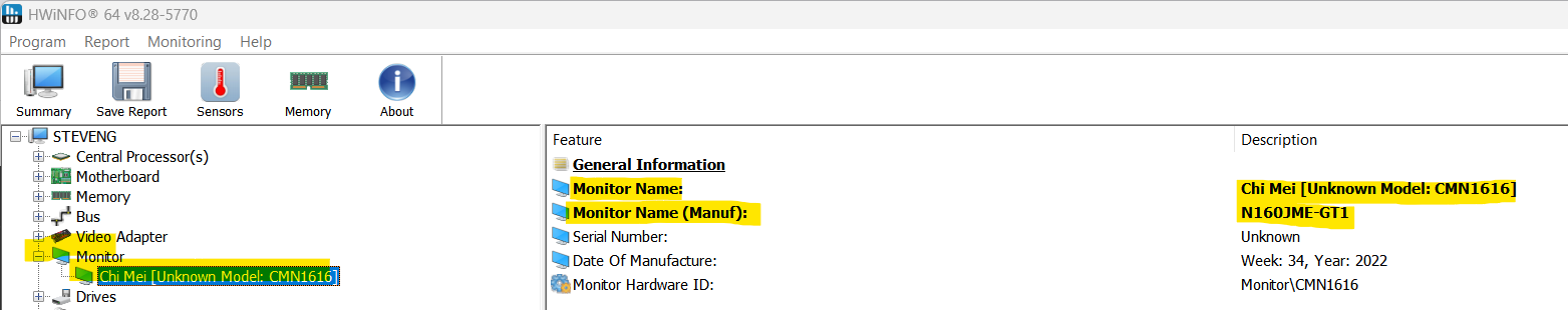

    To find out the model and part number of your current PH315-55 screen, install the HWiNFO64 software and look in this software's Monitor section like below for your PH315-55 screen name and model number.

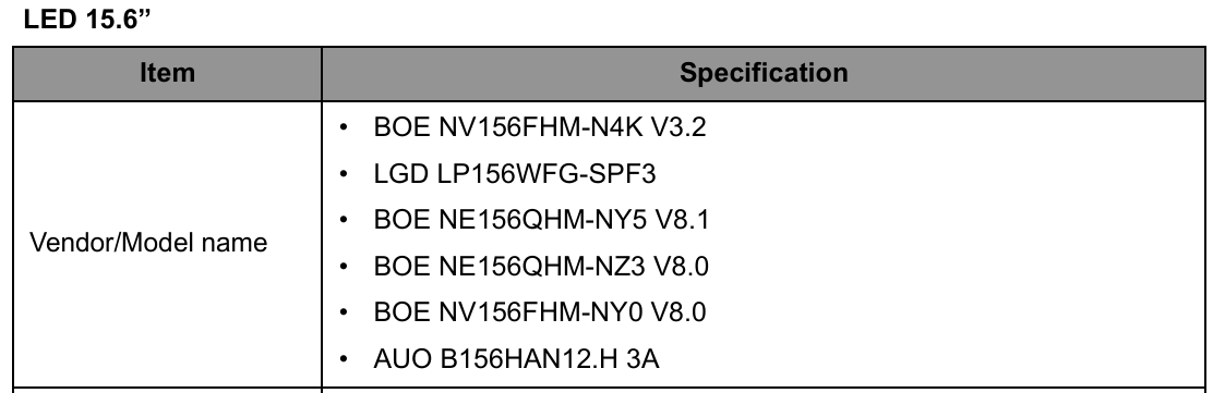

    If the eDP cable and its plugs have not shorted then replace the screen. Below is the eDP cable and all the screens for your PH315-55 model laptop. To buy a screens search on eBay in your country or look at LS Screens or Panelook.com site for the PH315-55 screens listed below. Good luck and hope this helps you out.

    Screens fitted by Acer for the PH315-55 laptop
