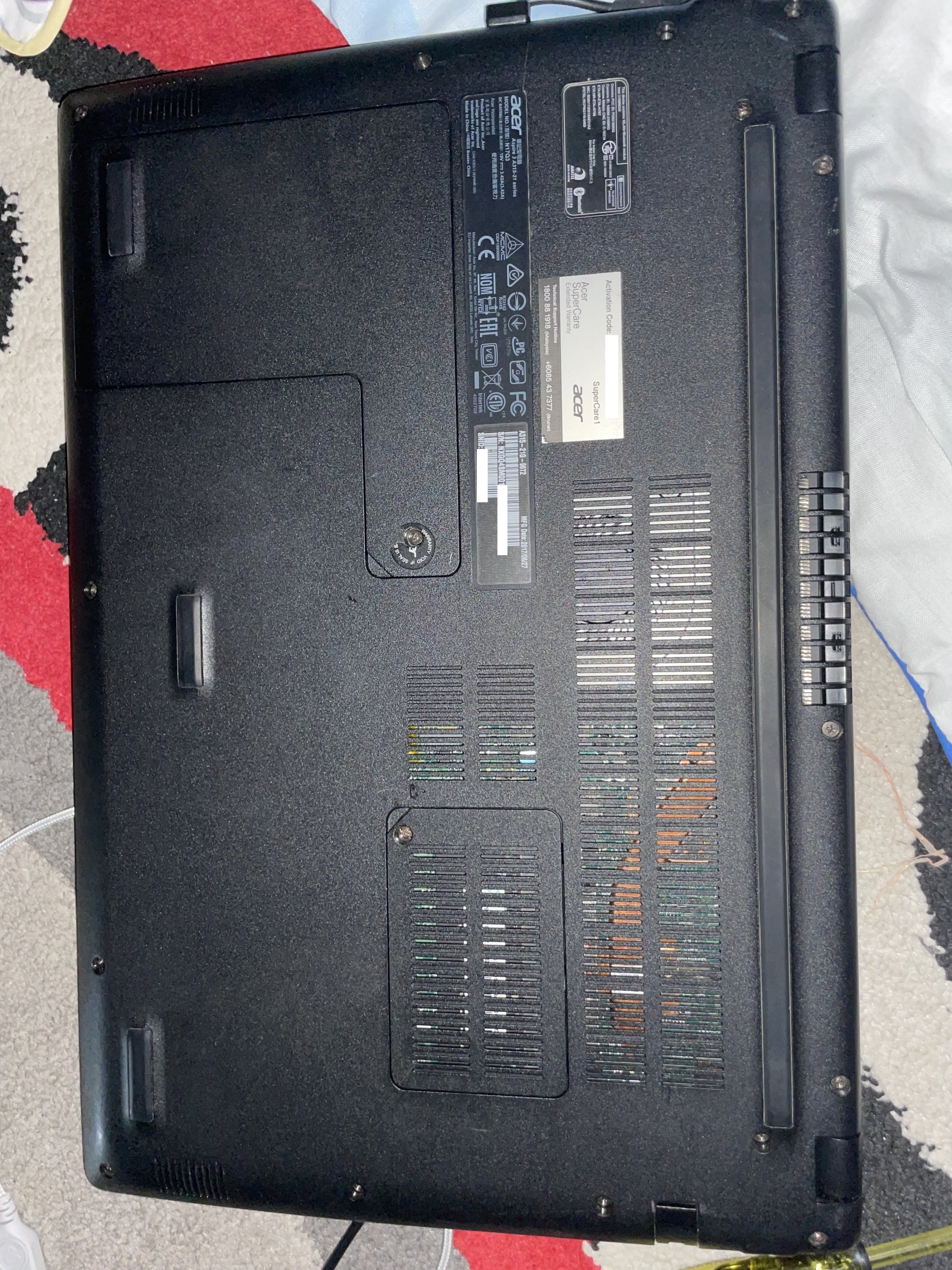

My acer aspire 3 laptop suddenly switch off while using it. How to solve it?
Minhwa
Minhwa Member Posts: 1 Newbie
edited 10:50AM in Aspire Laptops
Hi all.. my laptop suddenly switch off while i’m using it.. how i want to solve it?
i try to switch on but not success…
And where i can find the pink hole to restart the laptop?
[Edited the content to hide sensitive information]

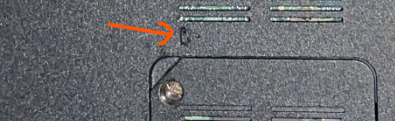

    Hi @Minhwa On the Aspire 3, the small pinhole with a battery symbol is at the far right edge of the laptop.
    Insert a straightened paperclip or pin and hold it down for about 15 seconds to perform an embedded‑battery reset. This can help if the system won’t power on after an unexpected shutdown.
    After the reset, reconnect the AC adapter and try powering on again.

    The pinhole battery reset is as shown below, look for the battery icon like below.

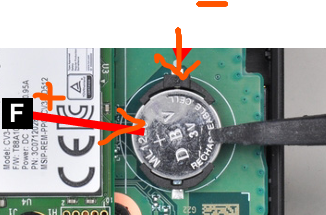

    Disconnect the main battery from its mainboard plug, then take the main battery out, press the power key for 15 seconds to release all power to the laptop, Then disconnect the RTC/BIOS battery and then short the RTC/BIOS batteries mainboard case middle which is the + pin with the side - pin (as shown below) to reset CMOS.
    Leave the laptop like that for at least 30-60min so that the EC, Chipset and bios chips reset completely and properly and then reconnect everything, if you have 2x ram modules, only connect 1x ram module and alternate the two ram modules and see if its not the ram that is faulty, as a faulty ram module will also stop the laptop from booting and give a black screen, do all the above as the laptop should turn on and boot properly with an image on the screen.

    That pinhole literally is the CMOS battery short pin. All you have to do is short that for a couple seconds do to a BIOS reset. You don't have to take out the hard drive, RAM, or anything else. Just unplug it from the wall, put a paperclip in the hole for 3 - 5 seconds, let it sit for about 5 seconds, plug it back in and test.

    NO ITS NOT a CMOS reset, as that pin resets the battery only, it does NOT reset the bios or EC chip properly as the laptop needs a proper long reset for a proper reset and for it to boot correctly.
