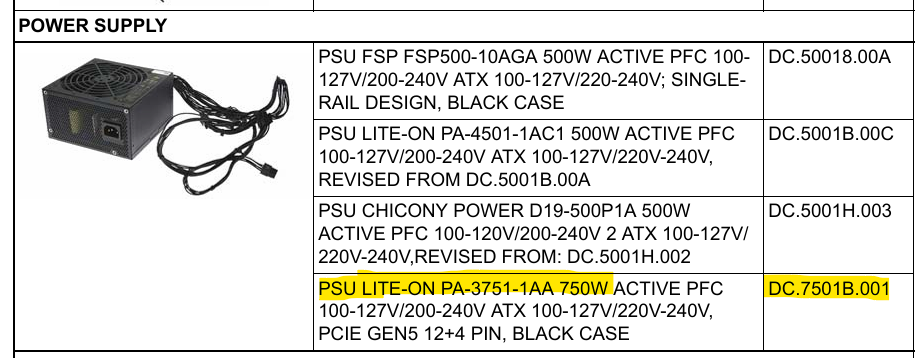

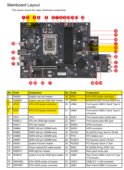

    The Predator Orion desktop model PO3-650(G) can only use 1x PSU that are provided and listed below, and it has an Acer proprietary designed mainboard that also uses 3x types of proprietary types of plugs and also has a 750W PSU to power its mainboard and components, these ATX power plugs are in the mainboard layout diagram below; at #18 the ATX1= 6-Pin ATX power connector, at #3 the ATX2=4-Pin ATX power connector, and at #4 the ATX3=4-Pin ATX power connector. Good luck as I'm sure that this will solve your PSU upgrade solution.
    These are the Acer fitted PSUs for the PO3-650(G) desktop and it has an 750W PSU models which you can upgrade to, so use the Acer part number and search the web, as they are available.
    PO3-650(G) Mainboard and its ATX power plugs

    I suggest that you use the Acer listed LiteOn 750W - part#: DC.7501B.001 PSU ($195.00) listed above for the Predator PO3-65G model desktop and DO NOT use any other 3rd party PSU, as the 750W PSU is tested and specifically designed for the PO3-650G desktops.
