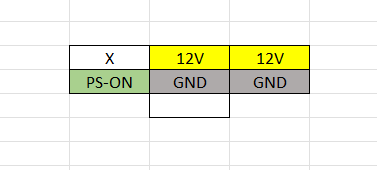

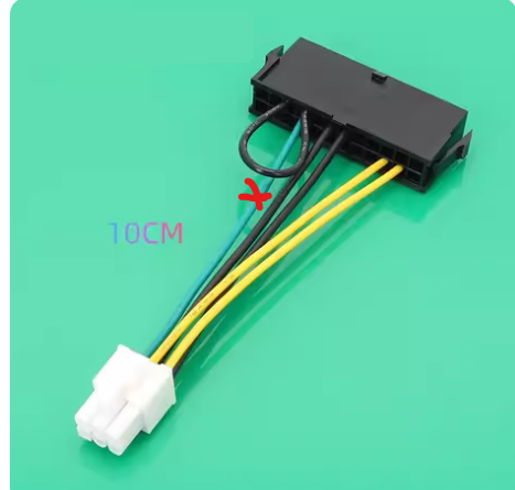

I got an N70-130 motherboard from used market, tried to power it with an off the shell 24pin ATX PSU and a 24pin to 6pin adapter specific to acer's pinout. It kind of worked.
Aside from 12V and GND, the adapter just shorts PS-On to GND which makes the PSU permanently on.

    I seem to have figured it out.
    Short answer: cut the green wire on the 24pin to 6 pin adapter cable, and everything works fine now.
    Long answer: It seems that the motherboard doesn't like its PS-ON pin being shorted to ground all the time. I don't know why but this seems to be the one thing that prevents the system from fully shutting down.
    After cutting the green wire which connects the motherboard PS-ON pin to the PSU side (but keeping the PSU's PS-ON pin grounded so the PSU is always on), the system acts all normal. After shutting down the CPU and chasis fans no longer spin and system no longer draws ~17W but a far more reasonable ~2W now, which is because of the PSU is always running.
    I don't know if there is a way to make the PSU switch off and only have its standby rail active. I don't think the motherboard has a pin to receive +12VSB. 2W when shut down is good enough for me at the moment.

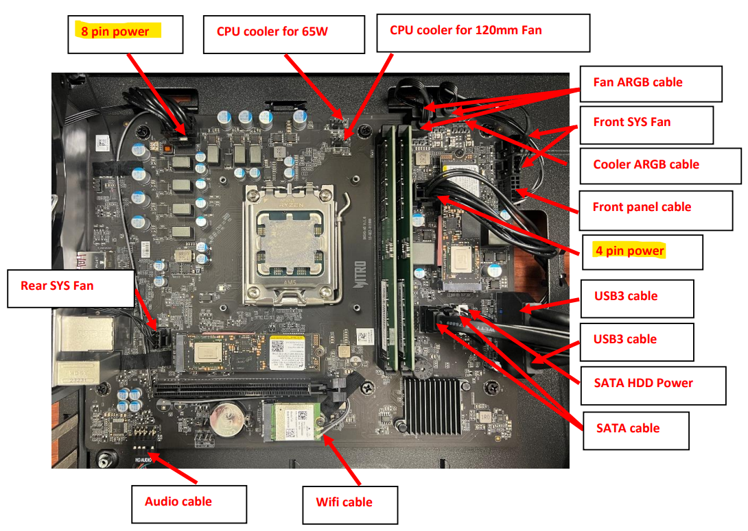

    Your Nitro N70-130 desktop comes oem from Acer with a 750W PSU and an RTX4070 gpu, why do you want to upgrade the PSU, as the Acer specs is what the Nitro N70-130 is designed for, upgrading this basic mobo will not give much more performance, the Acer quoted ram limit is 32GB at 2x 16GB DDR5-5200MT/s for this Ryzen 7 7900 cpu desktop.

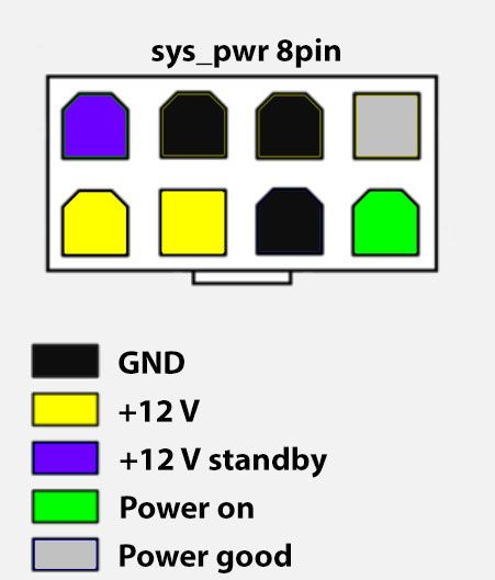

    The Nitro N70-130 has an 8pin main power plug and a 4 pin power plug (see mobo diagram below) where are you getting the 6pin from? As you need to buy a Power Supply Adapter Cable for Motherboards, 10.6" 24-Pin to 8-Pin 18AWG if you want to upgrade the oem 750W PSU to a higher wattage PSU (I suggest a modular one) to be able to upgrade to a higher spec gpu card, as your Nitro N70-130 desktop as this desktop is very well equipped oem from Acer, and with these prebuilt desktops, you would be much better off not spending money on upgrading and buying a higher spec desktop for gaming. Good luck and hope this helps you out.
    Nitro desktop model N70-130 mobo

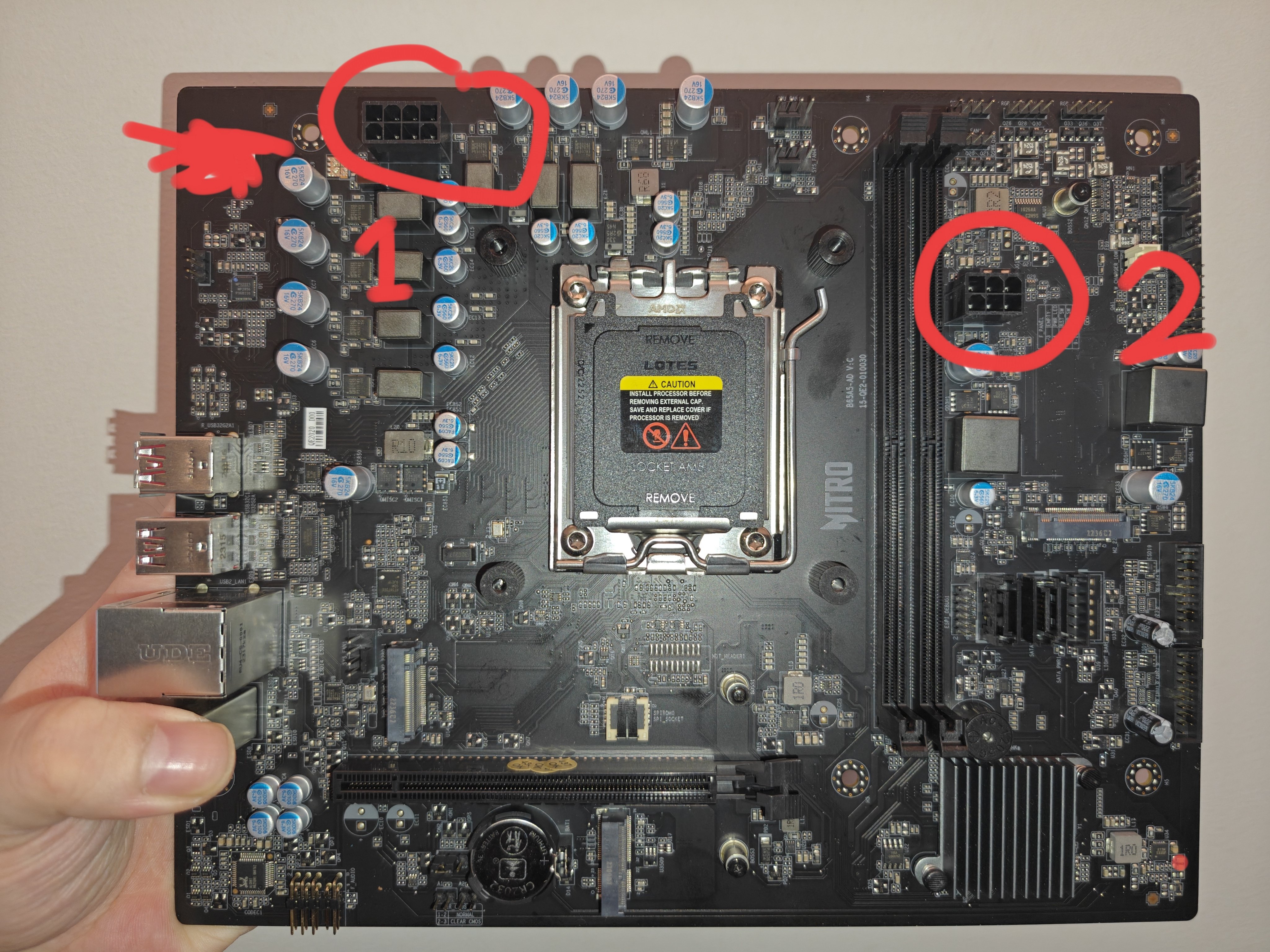

    This is the board I got. The connector on the top left is a 12v EPS, the one on the right I believe is for motherboard power.
  • physicsme
    physicsme Member Posts: 6 New User
    This is the board I have. I'm guessing port 1 is a 12v EPS because of its position near the CPU socket. And port 2 for motherboard power because acer often uses 6 pin for motherboard power connector.

    We don't have much information on the N70-130 desktop and its power mobo plugs in detail, we only have the Nitro Desktop N70-130 - Lifecycle Ext. Guide_Acer_1.0_A_A which has the mobo diagram above, so I cant tell you 100% what the 8pin plug is, but it is described as a power plug and there is a24pin to 8pin adapter cable so that you can attach it to a new PSU, seeing that the 6pin to 24pin adapter cable doesn't work, so try the one that I've given you above as its specifically titled as a power adapter cable and pretty cheap also.

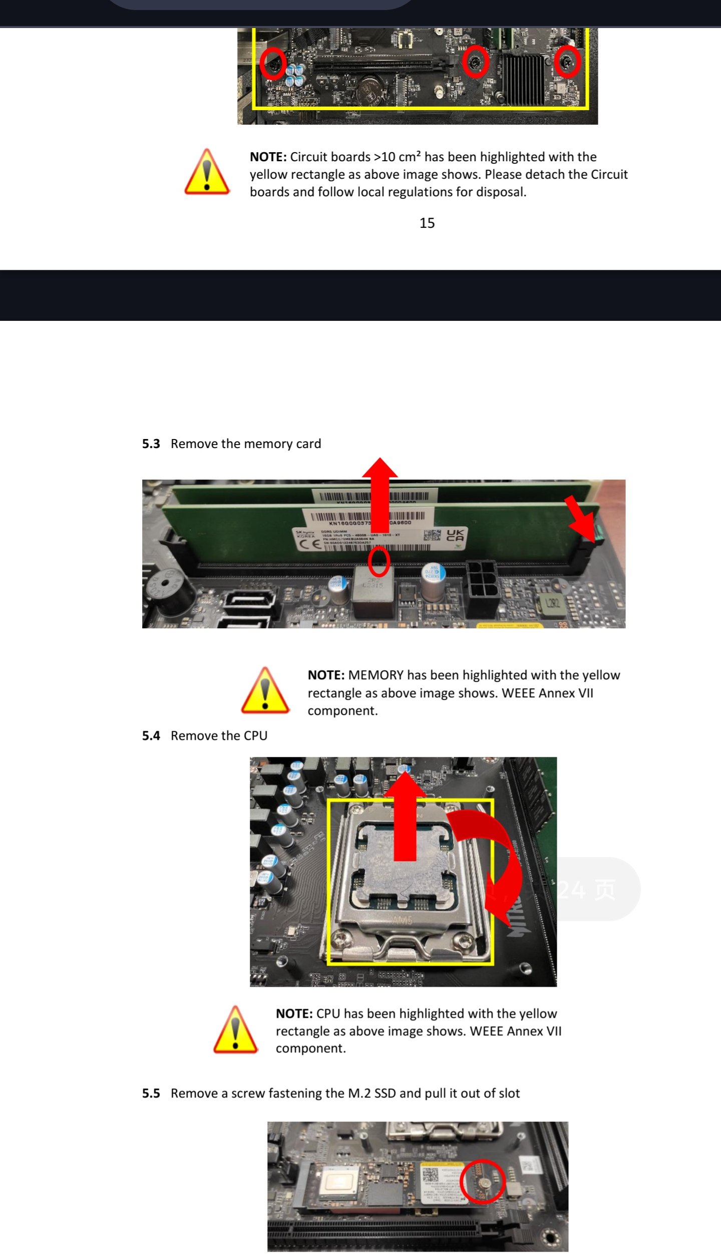

    Then the life extension guide is not very helpful and might be hazardous.
    I read the document and see one of the photos in there showing the power plug near the ram slots has 6 pins not 4. Yet the document says its a "4pin" connector.

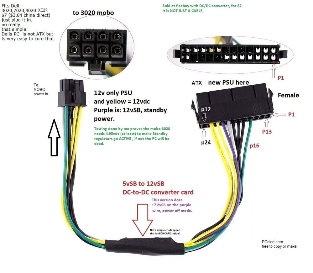

    The 8pin adapter you suggested would short the 12v rail of the PSU to ground if connected to a EPS 12V socket.
  • physicsme

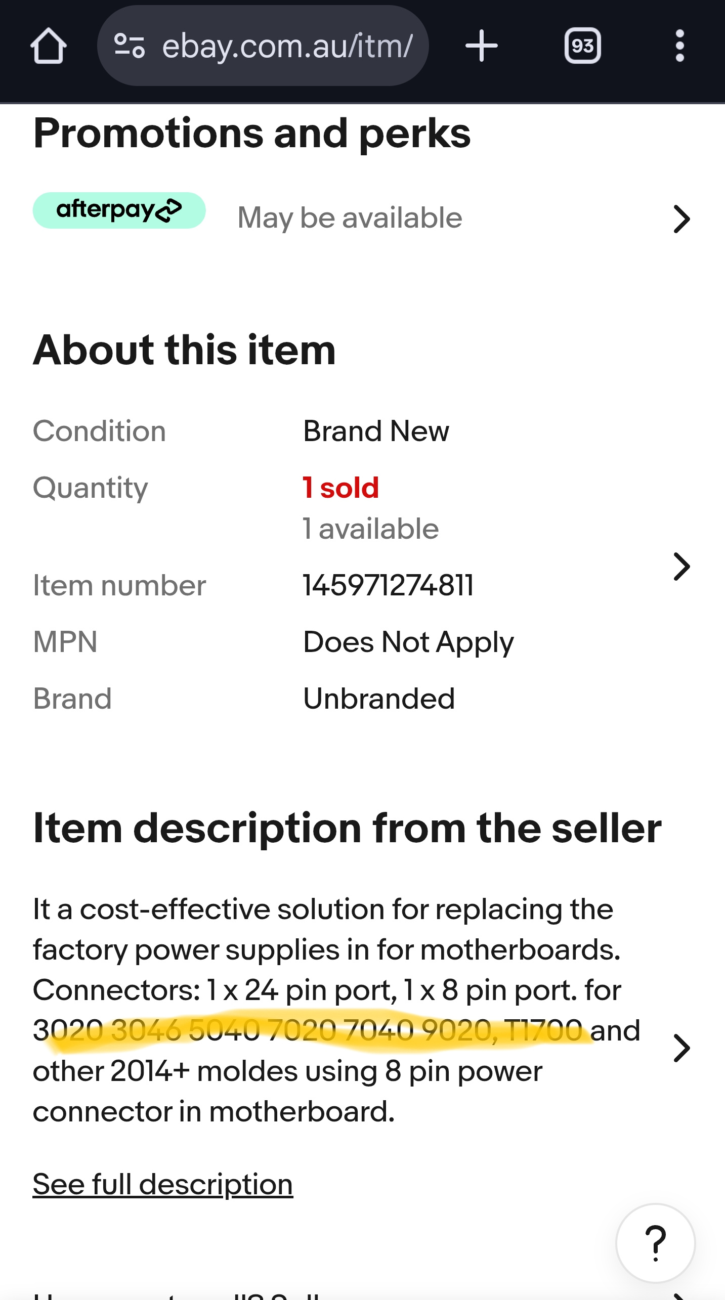

    The 24 to 8 pin adapter you showed looks like a dell optiplex pinout.

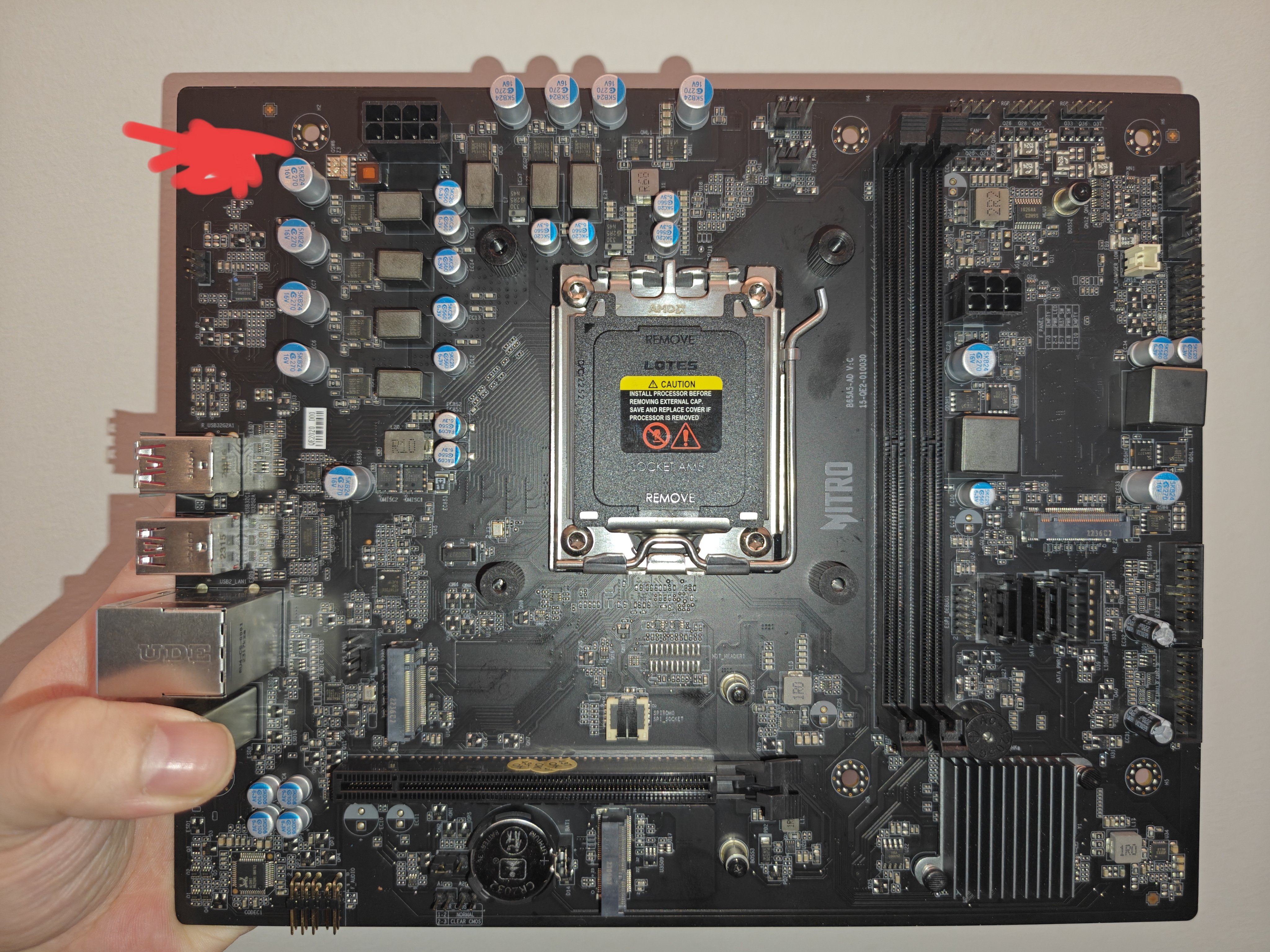

    This is the 12v EPS:
    I'm sure you can see why I'm worried about "shorting 12v to ground" here.
