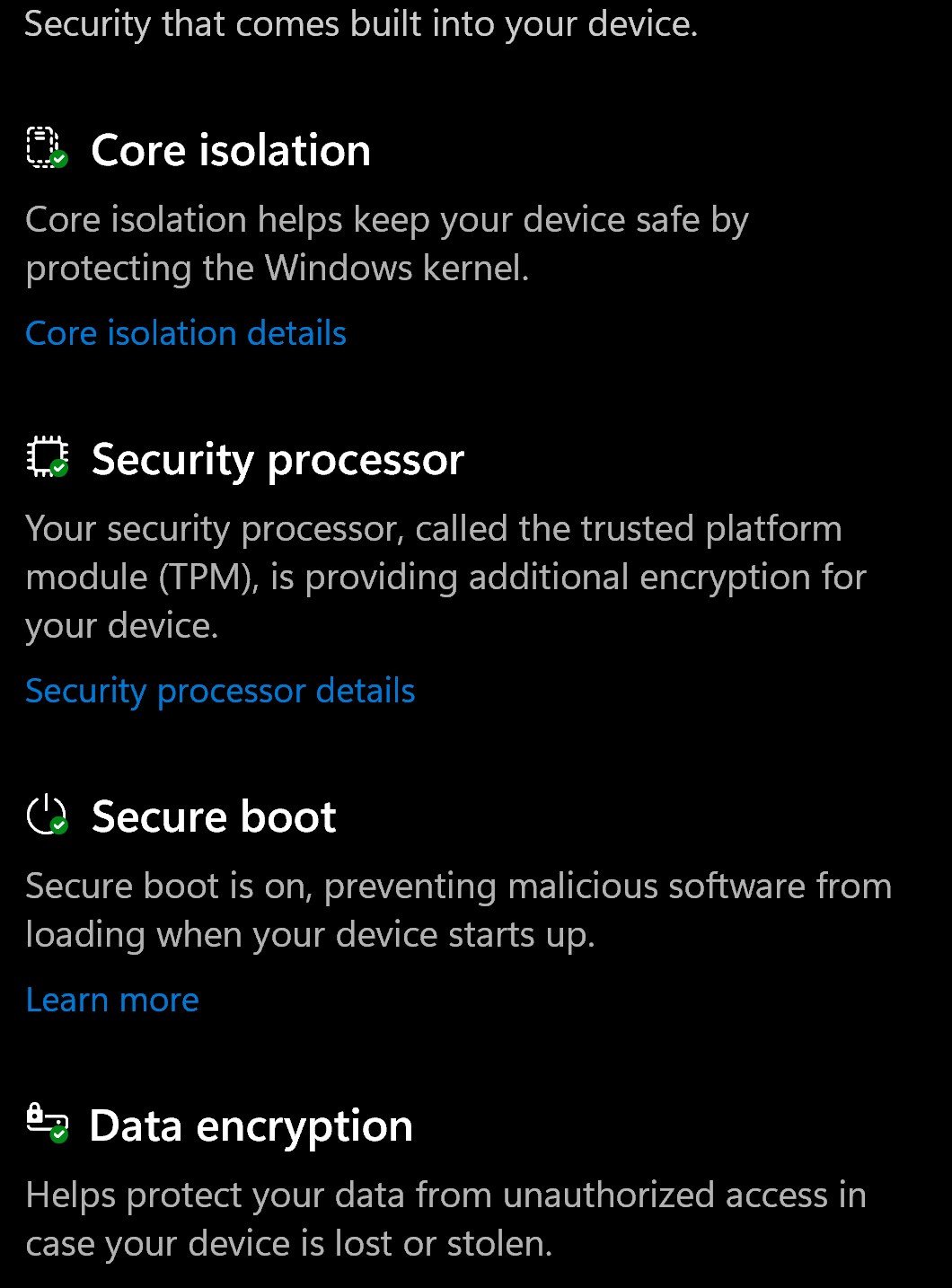

i have had my laptop for a while but for some reason it doesn't see secure boot on even though it is enabled in the bios (v1.15) im not sure what to do here. After troubleshooting for 3 days straight…..im left with nothing working. has this happened to anyone else?

    Predator PH315‑54 (2021) — TPM 2.0 present, Secure Boot supported, BIOS v1.15 (latest). If BIOS shows Secure Boot enabled but Windows/apps say it’s off, it’s usually one of these:
    • Boot mode mismatch (Legacy/CSM vs UEFI)
    • Missing or unenrolled Secure Boot keys
    • Non‑Microsoft bootloader path
    • OS installed on an MBR disk
    Quick “toggle and reset keys” (often fixes it)
    1. In BIOS:
      • Disable Secure Boot → F10 to save and reboot straight back into BIOS.
      • Re‑enable Secure Boot.
      • Set mode to Standard (not Custom).
      • Install/restore Default Keys (factory keys).
      • Ensure Microsoft 3rd‑party UEFI CA is enabled/allowed.
      • Set boot to UEFI‑only (disable CSM/Legacy).
      • Keep Windows Boot Manager first in boot order.
    2. In Windows:
      • Windows SecurityDevice security → Secure boot should show On.
      • Press Win+R, type msinfo32:
        • BIOS Mode: UEFI
        • Secure Boot State: On
      • powershellConfirm-SecureBootUEFIExpected: True.
    If it still reports Off or apps complain
    A. Check disk type and convert if MBR
    1. Press Start, type cmd.
    2. Right‑click Command PromptRun as administrator.
    3. cmdmbr2gpt /validate /allowFullOS
      • If you see “Validation completed successfully”, continue.
    4. cmdmbr2gpt /convert /allowFullOS
      • After “Conversion completed successfully”, reboot straight into BIOS.
    5. In BIOS:
      • Disable CSM/Legacy, set UEFI‑only.
      • Re‑enable Secure Boot, restore Default Keys.
      • Keep Windows Boot Manager first.
    B. Force Microsoft bootloader path
    cmd
    bcdedit /set {bootmgr} path \EFI\Microsoft\Boot\bootmgfw.efi
    C. Disable test/integrity overrides
    cmd
    bcdedit /set testsigning offbcdedit /set nointegritychecks off
    Reboot and re‑check msinfo32 and Confirm‑SecureBootUEFI.
    Quick triage info (if posting back)
    • msinfo32: BIOS Mode + Secure Boot State
    • CSM/Legacy option in BIOS: present/on/off?
    • Disk layout: diskpartlist disk (asterisk under GPT = yes)
