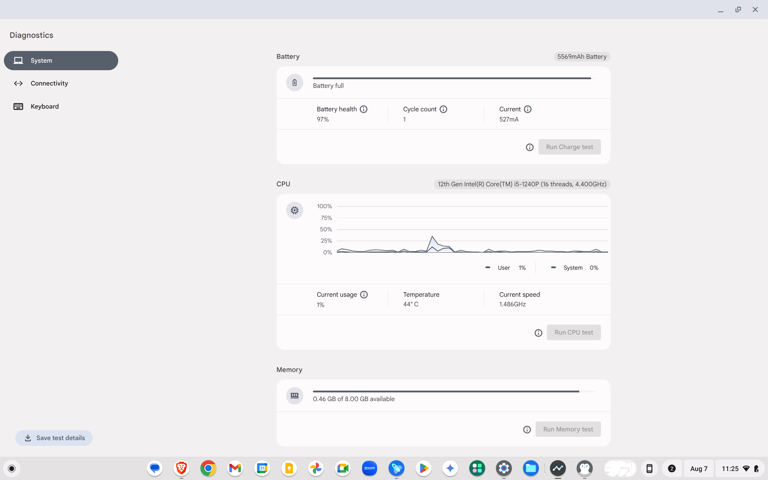

Hi - I just bought a brand new Chromebook Plus 516 (CBC516-1H-53TY) with 8 GB RAM and 12th Gen Intel Core i5-1240 16 threads 4.4 Ghz processor and 256 GB storage.

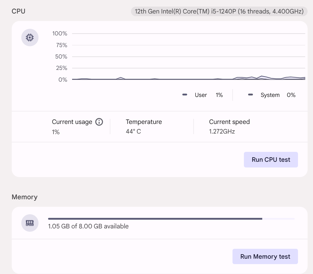

I literally only have Chrome running with 2 tabs, no apps running, or anything else. My diagnostics test is showing I only have 1 GB of 8 GM memory available. My Chromebook is extremely slow and lagging. I can't see in the diagnostics report what apps are taking up the 7 GB RAM.How can 7 GB of RAM being used with only Chrome running with 2 tabs?
How can I clear up some RAM so my Chromebook will speed up?

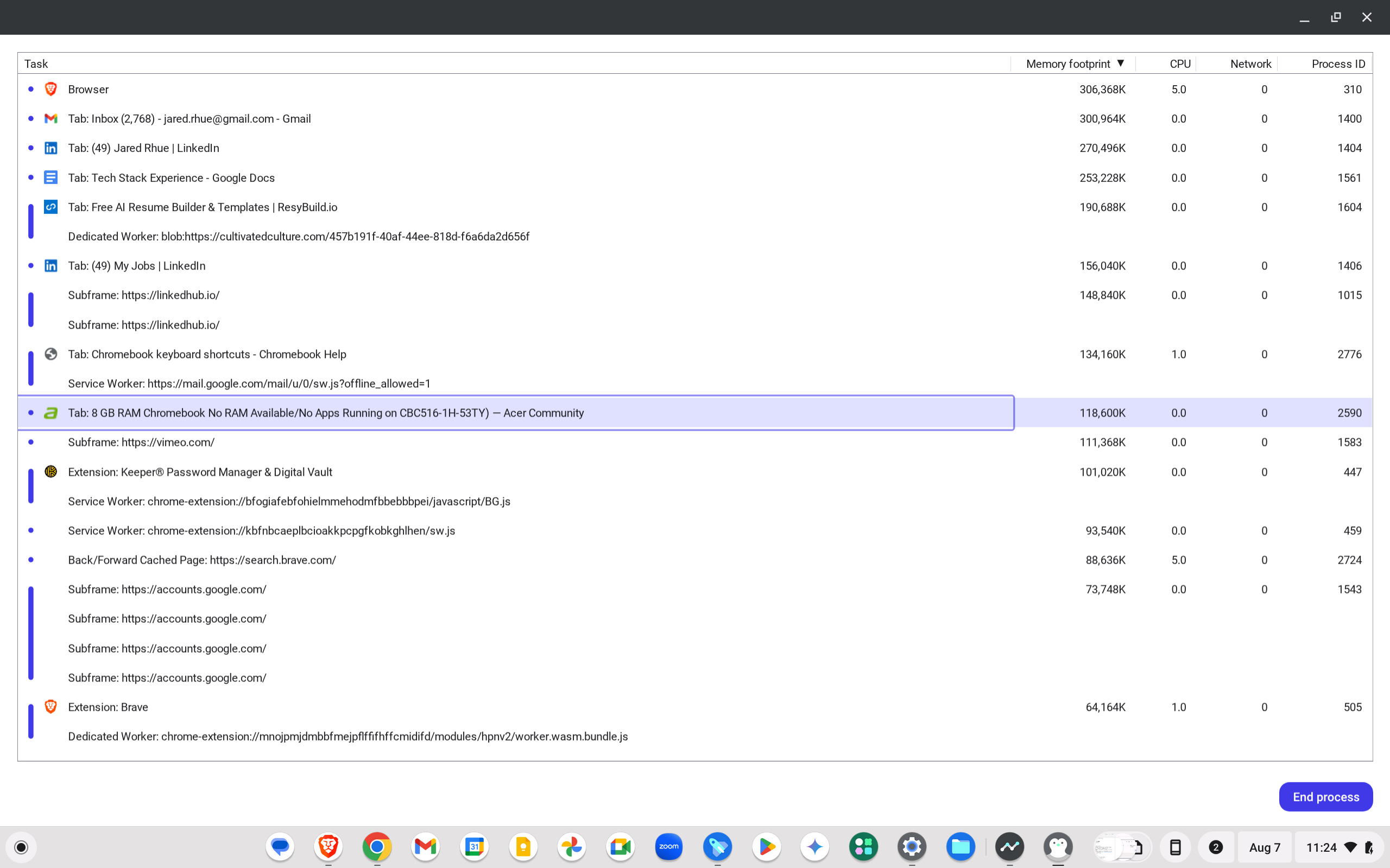

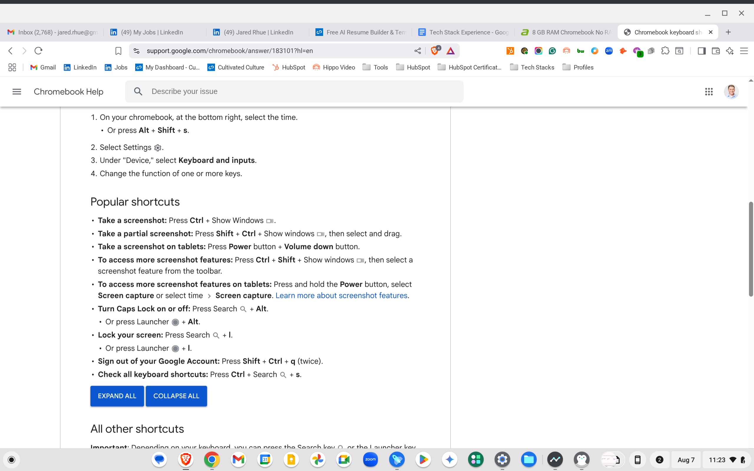

    Hi Puraw! I can't thank you enough for your thorough and prompt response of help! I did the quick check tasks you recommended. I've attached a screenshot of my task manager report. Could you please take a look at it and let me know what you think? I think you might be on to something with your extension audit recommendation. I have a lot of Chrome extensions installed for my work. See the screenshot I attached. Could this be the issue?
    Another question if you wouldn't mind answering…Does my Chromebook model able to upgrade to a 16 GB RAM? Either 2 8 GB sticks or 1 16 GB sticks? I'd love to upgrade it to improve the speed.
    Task manager report

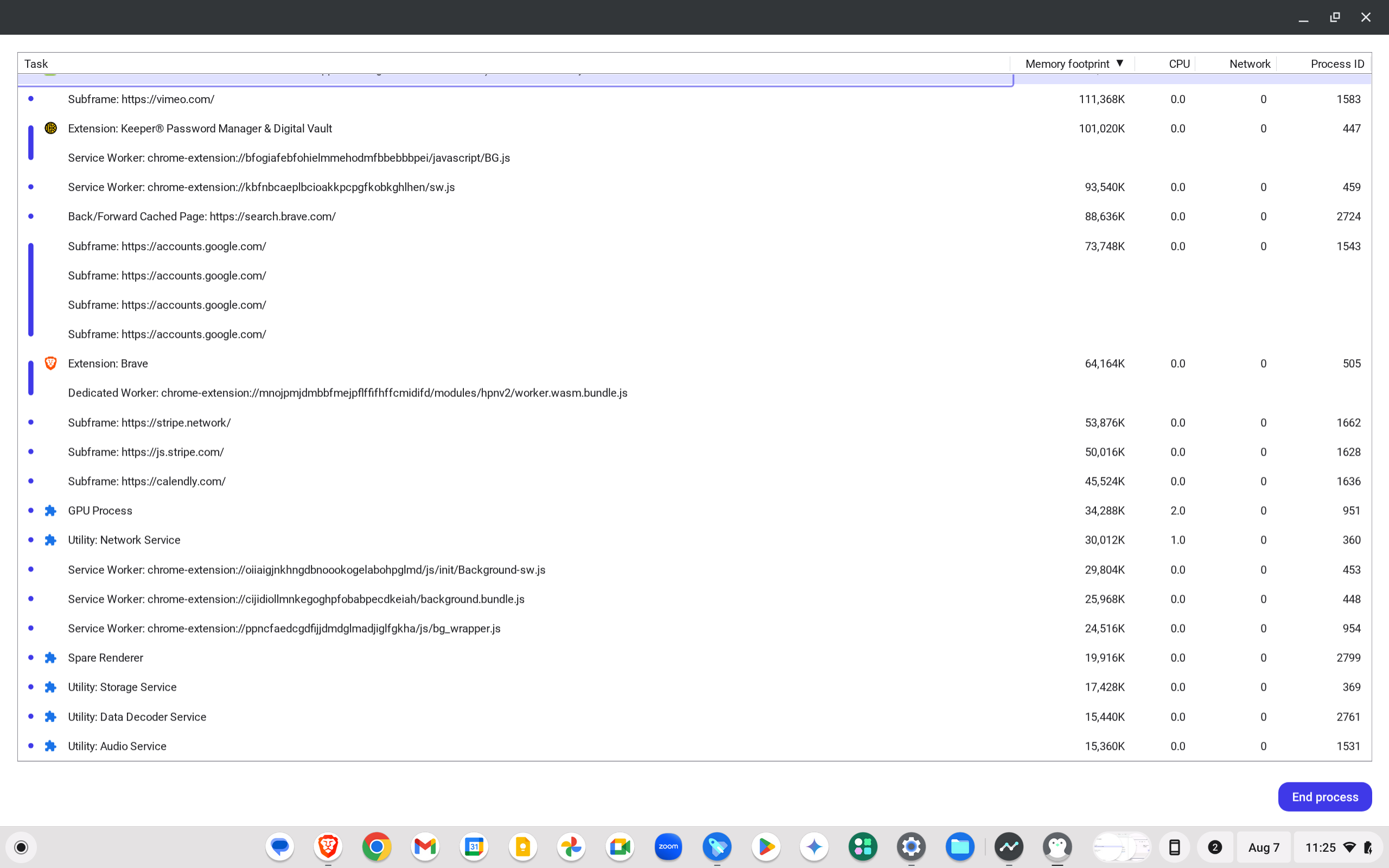

    The second half of page running tasks

    Current Diagnostics
    Chrome extensions installed (top right)
