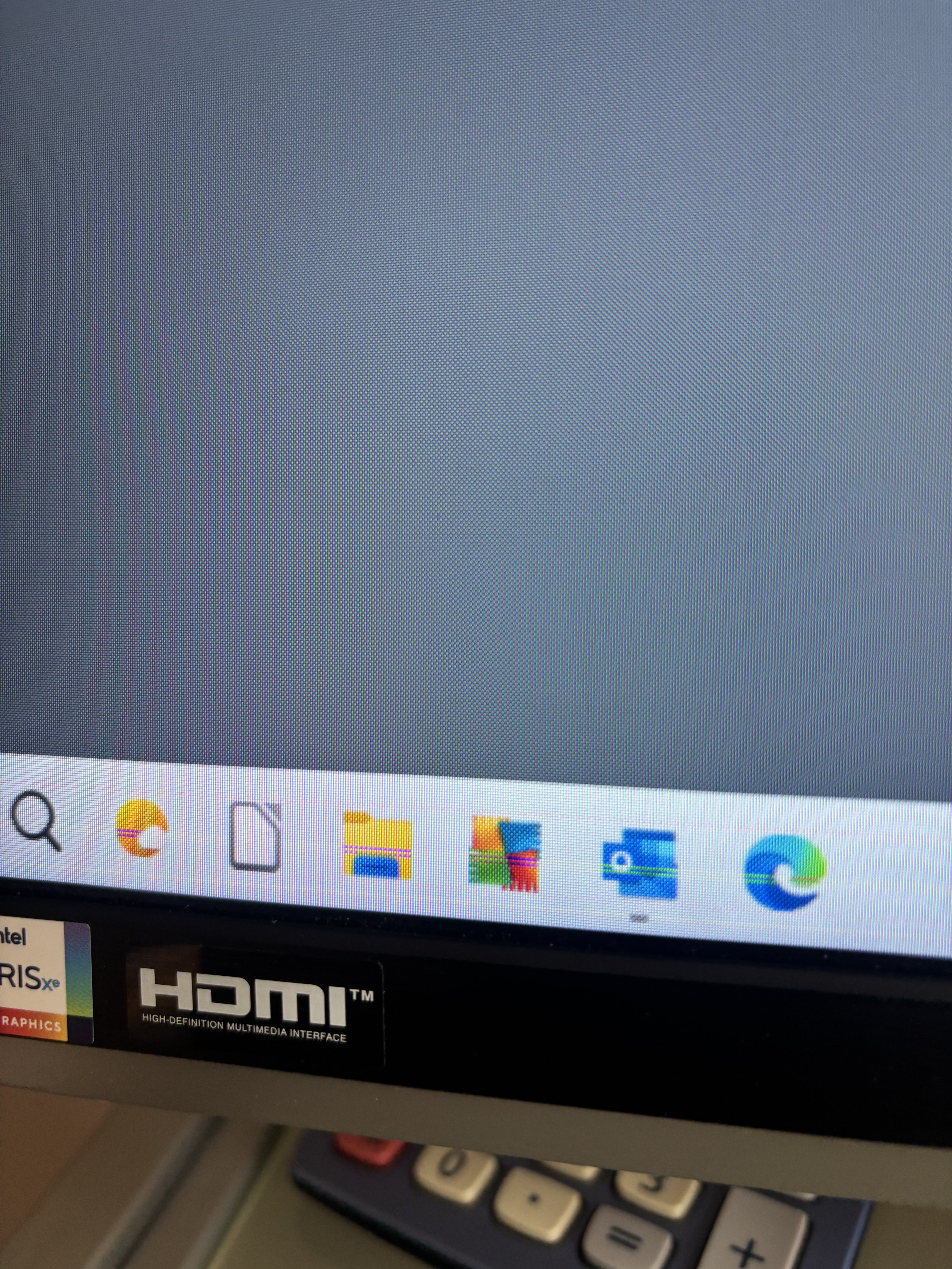

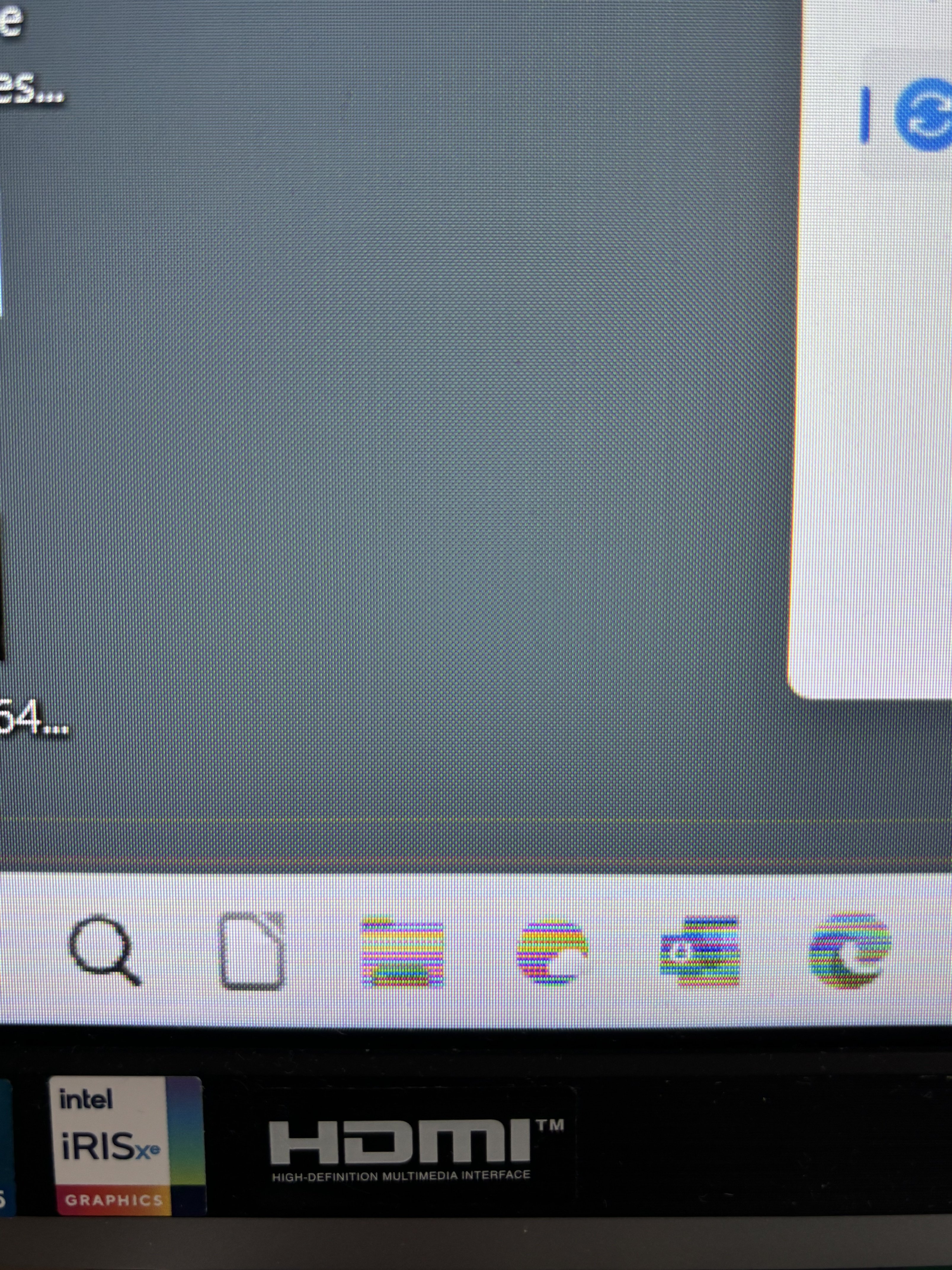

    I also have this issue - same Acer all-in-one model as op - except it has horizontal lines, and only at the bottom of the screen covering the taskbar. (They remain when explorer is restarted).
    Would anyone know if this might also be a cable connector issue please ?
    No driver updates are available and this screen hasn’t moved for a few years, ie: hasn’t been dropped.
    Thank you
  • Larryodie
    Larryodie Member Posts: 2,009 Expert Leader
    I'd clean the contacts on the data cable and if you desire then buy one but my opinion is that you need a new screen assembly.
    There are numbers on the back of the screen, search EBAY for those numbers (exact) numbers. Good Luck.
