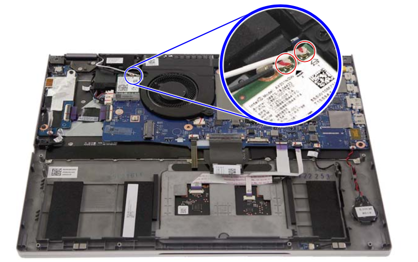

    One thing I am having an issue with are the Wifi 1 and 2 connectors the white and grey wires that connect to the wifi chip. I feel the connectors should clip on easily, they dont and its annoying me. I cant believe this more difficult than what I just did
    I feel there is something wrong with the wifi chip connectors?

    Yes the Wi-Fi antenna AUX and MAIN wires plugs at the card are annoyingly small and if you damage the plugs then you will never ever be able to clip them back properly again and you will need to get new antenna wires.
    This happened to my Nitro AN515-56 laptop when i tried to upgrade the WLAN card from its oem Wi-Fi 6 to a better Wi-Fi 6E card that didn't work and it was a waste of time and I did the same as you and damaged the antenna wires plugs that didn't clip into the cards pins, as you really need a microscope to plug these plugs into the card pins properly. If that is what you did then you have two options:
    1. Get new antenna wires and re route them to the LCD panel and reconnect these wires to the card
    2. If you have a good soldering iron then solder the white/black antenna wires clips to the WLAN card pins, as that is another solution
    Good luck and hope this helps you out.

    The AX201NGW cards all supposed to be the same, but there are lots and lots of different vendors assembling them. They all have to use the same chipset (the AX201NGW part) but may or may not use exactly the same additional circuitry. Buying from a reliable vendor should be all that's needed to be sure to get a good one. For yours, the white and black antenna wires should be connected like this:
    So, white to the outside, and black closer to the screw 'hole' at the edge.

    I got my new Wi-Fi chip today and was able to connect the Wi-Fi and all new cases. Looks like a brand new laptop and grateful that Acer made it so easy to repair this laptop. I was told $700 from Acer and I ended up repairing my Spin 5 for under $100.
