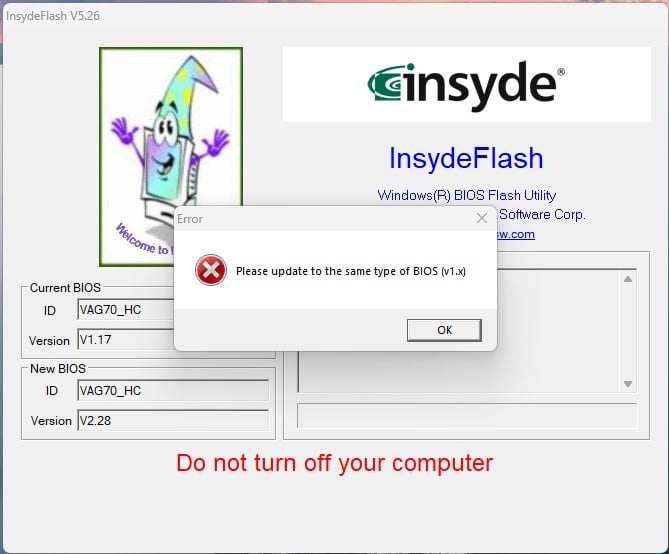

    It's not letting me update the BIOS. It's giving me an error message about secure boot. But not only that it's saying that I have to start with 1.x which (1.17) is the one that I'm on.
  • StevenGen
    StevenGen ACE Posts: 14,799 Trailblazer
    Try the version 1,28 first and see if that installs, then try the 2.30 version, otherwise take a caption and sow us what the Insyde bios flash error is.

  • luigip
    luigip Member Posts: 13
    Tinkerer
    I don't have any other 1.x Versions.

    This is with 1.17
  • StevenGen
    Check that your SATA Mode Control the mode in which the SATA controller should operate. AHCI or IDE laptop that its in AHCI mode and not IDE mode > @ BIOS > Main > SATA Mode > AHCI which "Controls the mode in which the SATA controller should operate" as there are two settings > AHCI or IDE" as that could affect the 2.xx bios updates also.
    If you haven't replaced the RTC/BIOS battery replace the battery as after 13 years this laptop needs a new battery, then and after you take the old battery out, shot the plug +&- pins to reset CMOS and leave the latop without ram and main battery overnight, as this is a hard rest and then reflash the bios and see if the bios updates. Also, it could be that the bios chip is too old as the Aspire E1-731 was released in 2012 and the bios chip could be faulty and can't be updated, and will need a new bios chip.
    Its also very wise to search the web and enquire from retailers that sell and program these chips if they have an Aspire E1-731 bios chip replacement for sale and ask them what bios version they sell their new bios chip for the E1-731 laptop with.
    Here is a retailer on eBay "BIOS CHIP: ACER ASPIRE ES1-731 ES1-731G ES1-731P ES1-731PG" that sells these bios chips and could also sell a bios chip for the Aspire E1-731, so enquire with them as there are allot of bios chip retailers on eBay. Good luck and hope this helps you out.
