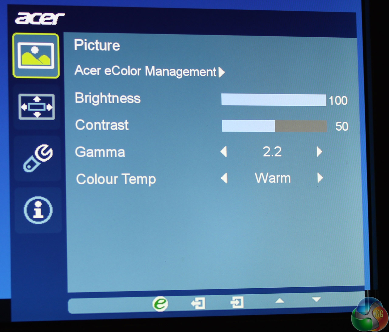

    >>>it has a Quick Start manual, but the full menu doesn't mention a Quick Start function.>>>
    If it exists, it'd be in this OSD menuitem. These manuals often apply to other models so the OSDs can be different.
