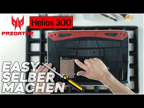

    Hmm, if you meant whether I have opened the bottom of the machine and actually removed the battery... I haven't tried that.
