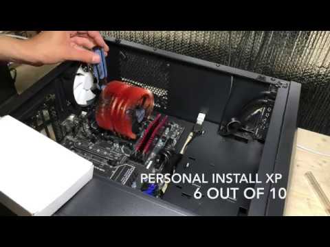

    For anyone searching around these days for the best replacement heatsink and fan for the i5 or i7 systems, I came across this one. I ordered it but have not installed it yet, however, it is designed to fit LGA11XX which is the same as LGA1200 for the screw holes on the boards. I'll update the post when I do this eventually, but something to consider for those looking.
    Because they designed this heat-sink to work on many models with their mounting kit which requires to pull the system apart and put in a new plate, I have not had the time to pull the system apart yet to confirm everything, but do not pay attention to the Amazon sizes listed for these. In the pics, you see the true size of it, by clicking on one of the actual images to bring it up in a popup window, there is the actual size listed there. Even appears that you will be able to have all RAM sticks in with this one. Below is vid and below that's the amazon listing. For 50$ total Canadian, it's a steal!
    Images with size

    I found a couple sites that show it is supported with LGA 1200, so those out there that may feel hesitant about the Amazon listing and newegg listing, Walmart US shows the 1200 support and another site I fond does too. I only put the walmart in below, though.
    https://www.walmart.com/ip/ZALMAN-CNPS-9500-AT-Processor-cooler-for-LGA775-LGA1156-LGA1366-LGA1155-LGA1150-LGA1200-copper-92-mm/23141221
