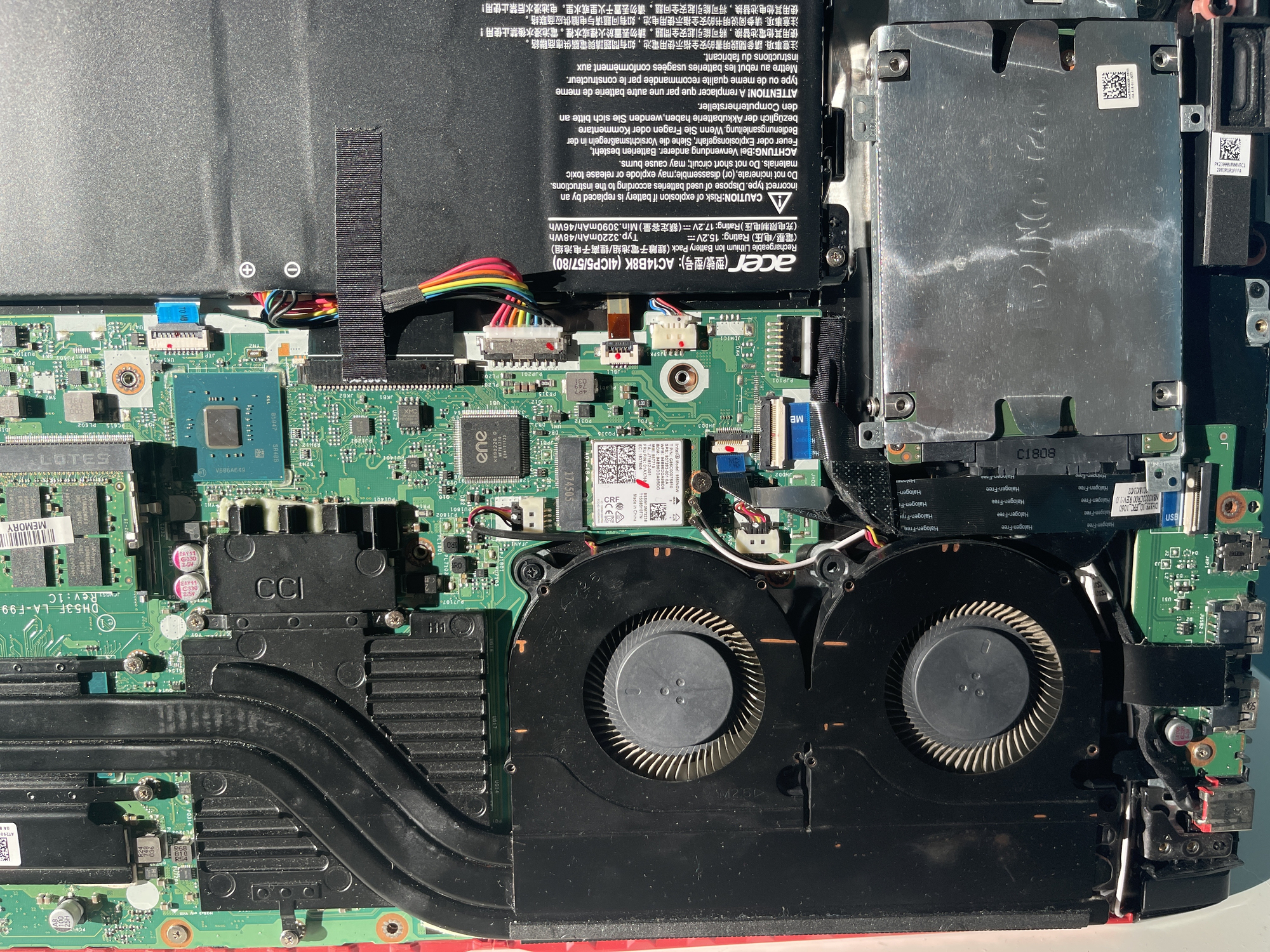

    I’ve made sure the fan connectors are plugged in correctly and made sure they weren’t pinched but they still do the same thing. I’ve attached a photo in so that you could look for yourself but I’m pretty sure nothing is wrong. I don’t know if the photo will help.

    @JBuzzy I see that those screws for holding the fan shell are missing. Also is there any small switch above the RAM slot?

    I had sent my laptop to predator themselves back in December 2020 and this is the first time I’ve opened it. I had realised that two screws were missing from the shell so I assumed they forgot to put them back in. I can’t see a switch above the RAM slot. Could you provide a photo of what I’m supposed to look for?
