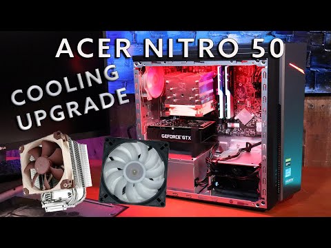

    check on youtube, theres a video where they upgrade the tower fans n cpu heatsink n fan https://www.youtube.com/watch?v=stFeDIY-FEA&t=5s

    Oh, that's great, I really appreciate that someone created a video about upgrading the cooling system. He also did a better job with it - he used 92mm fans and screw kit to mount them. Even the CPU cooler was a better choice and was compatible with that metal backplate that is originally mounted on the motherboard. Unfortunately 14mm CPU fans are too big and won't fit.
    As I remember there was a CPU and system Fan connectors, so there were two of them and I used a splitter to get 3 fans working.
